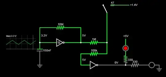

Always start with full specs or functional expectations as one addition might be implemented differently such as "open Circuit detect"
- Logic Probes may use Schmitt triggers to detect the valid logic state.
- Dynamic states or glitches are detected and displayed by a <= 1 second toggle.
- Invalid levels may be detected with a dual Op Amp amp window comparator.
- Vdd may be supplied by an internal regulator with switch options or alligator clips to D.U.T.
- Open Circuit may detected by dual OA window comparator with the probe biased to mid-Vdd - the probe could also be used to inject voltage at high impedance for CMOS with a 1Hz clock.
- Indication can be both LEDs dim or OFF or as you specify.
- Input impedance ought to be >=100k and input capacitance < 10 pF.
This is a partial solution without glitch detection. You can switch to simulate an open circuit and then slide the voltage to the probe. Simulation

                    Is the oscillator required or I can provide a fixed "mid point" voltage by another solution? OFF TOPIC: The link is broken, too many schemes :) "https://%20http://ww". – Elian Russel Sep 05 '22 at 08:27
                    Fix link. Nothing is required unless you specify it, like I did. It was just a novelty to inject pulses while being high impedance and open circuit detection in one circuit – Tony Stewart EE75 Sep 05 '22 at 10:24
