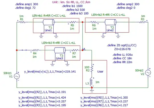

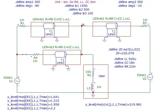

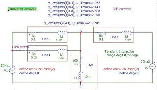

Here is a "simple" example "showing" that it is the "phase" of the voltage generators that are modified to make "circulating" powers in the network (ok, local losses line can change a bit, because "currents" are modified). Lines are also simplified to an equivalent "R-L" circuit.
The power into the Load remains "constant".

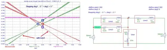

Line3 is a new line added to the network (shorter than the others).
What you see is that the cross point (0 degrees, red circle) is shifted to the left (-0.7 degrees, blue circle), because V1 has now more influence than V2.
So, V1 "inject" more power into the Load than V2 (0 degrees, blue rectangles).
This behavior can be changed by "shifting" the phase of V1 as you can see.
NB: this can be done although the amplitude of generators remains the same.
Interactive file made with microcap v12.
Interactive file with "High Voltage lines", parameter code "BlueBonnet".
Made with microcap v12. Parameters line : R, L and C, a bit more difficult.
Added resistors at the Load location to measure currents at the outputs of the lines (RMS values).
