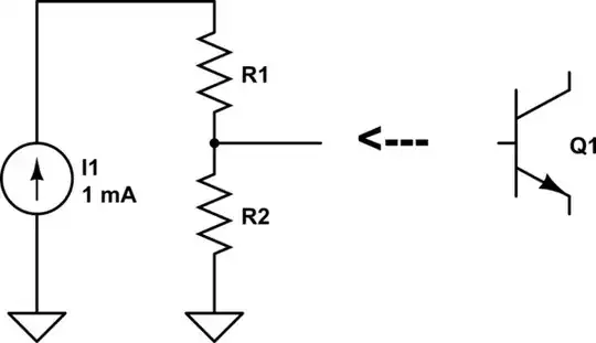

If the bias network looked like this:
schematic
Then the Thevenin resistance would be R2 and the Thevenin voltage I1*R2.
With regard to your second question, when considering the Thevenin voltage, the current Ib is not there. You're only looking at three parts- the voltage source and the two resistors. Thevenin voltage is the open-circuit voltage.
