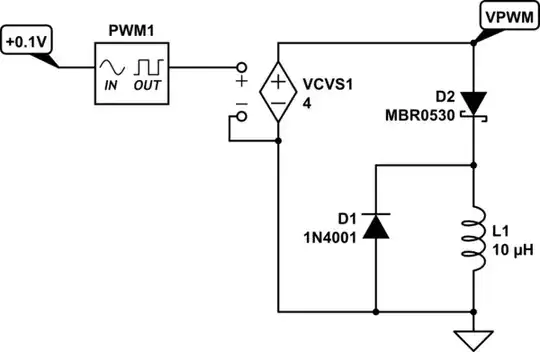

Let's set up a simulation here in CircuitLab: PWM frequency 20kHz, PWM control voltage range 0-10V, PWM output voltage 0-5V. So, the PWM pulses are 1% of 50us, so 500ns wide. The voltage-controlled voltage source is just a x4 amplifier, so VPWM is a train of 20V, 500ns rectangular pulses.
schematic

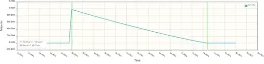

The inductor current waveform for each PWM pulse:
Inductor current waveform

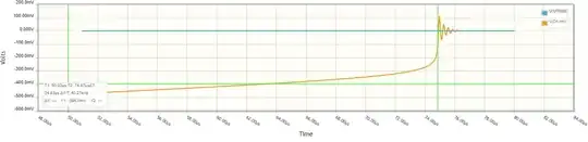

The D1 diode voltage during each PWM cycle:
Diode voltage waveform
The average diode voltage drop is about 0.4V, not 0.7V!
The inductor current at the end of the pulse is $$ I = \frac{1}{L} \int V dt = (10{\,\rm \mu H})^-1 \cdot 20{\,\rm V} \cdot 500{\,\rm ns} = 1{\,\rm A}. $$ This agrees with the simulation.
The rate of change of current in the inductor is determined by the inductor voltage, set by the diode voltage across D1. We consider the inductor "discharged" when the current falls back to 0: $$ \Delta I = \frac{1}{L} \int V dt = \frac{1}{L} \cdot V \cdot T \\ T = \Delta I \frac{L}{V} = -1{\,\rm A} \frac{10{\,\rm \mu H}}{-0.4{\,\rm V}} = 25{\,\rm\mu s}. $$
This matches the inductor discharge time in the simulation.
