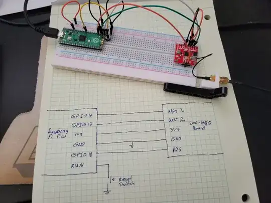

For the sake of fun and learning, I'm trying to make the most accurate wall clock I possibly can, driven by GPS. I'm starting with a u-blox ZOE-M8Q breakout board I got from SparkFun, and a Raspberry Pi Pico microcontroller.
At a glance, things appear to work just fine. The GPS receiver ACKs my config messages, it sends the messages I want, the checksums match, the reported time and location seem close to right, the validity flags are good, it sees about 11 satellites, and the PPS signal is close to aligned with the top of the second (comparing by eye with my NTP-synced computer).
test setup and schematic

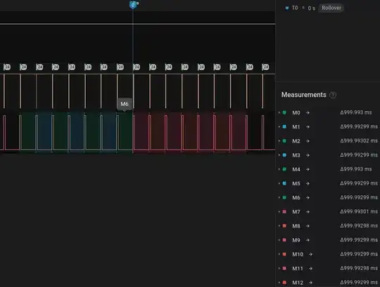

In actual fact, I observe phenomenon #1, but not phenomenon #2. I have double checked this with a logic analyzer to rule out a bug in my code. The actual elapsed time between pulses does not change when there is a 1 ms discontinuity in the reported times. This means that either the pulses before the discontinuity do not have accurate timestamps reported in the UBX-NAV-TIMEGPS message, or the pulses after the discontinuity do not (or more likely both are inaccurate). The UBX-NAV-TIMEGPS message is reporting a Time Accuracy Estimate of under 40 nanoseconds, so these results should be impossible.

I had my logic analyzer running at the same time, and it saw the same thing (T0 marks the time of the pulse just before the first message reporting a negative fTOW).
logic analyzer output

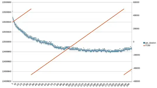

Here is a graph of pps_duration and fTOW over time.

    @NeilForrester no problem, good luck (I undertook a similar project in the past). In case it wasn't clear, basically all of the variation you're seeing in pps_duration beyond +/- 4 clocks is due to the Pi Pico's own oscillator drifting (mostly with temperature). – hobbs Aug 29 '22 at 04:28
