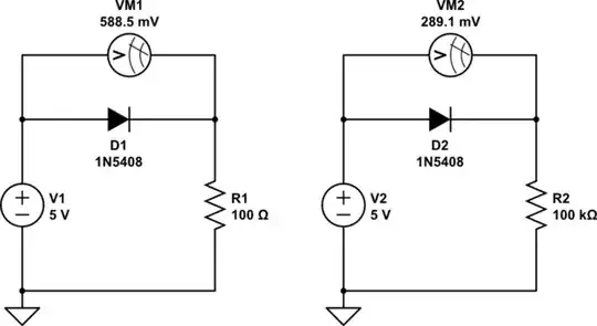

How do I know that a diode drops 0.7 V when it's forward biased?
I've had this problem in this circuit:
schematic
I know that it depends on the current and it is probably small, but when can I just say (without calculating) that my diode drops close to 0.7 V?
I just don't want to calculate this kind of thing in real life and I don't know when can I ignore calculating something and say "yea, diode has 0.7 V"

    Measure it with a volt meter! –  Aug 27 '22 at 20:11
    @James But usually in calculations people says that it is 0,7V or 0,5V and calculates still. But yea here I have 0,29V – user331990 Aug 27 '22 at 20:14

  • When you care about diode voltages in Falstad, choose an appropriate one like 1N4148 rather than the default (high power diode) with a saturation current of 171 nA. Even the Spice default model has a higher Vf at ~ 50 uA My rule of thumb is 0.6V @ 1mA – Tony Stewart EE75 Aug 27 '22 at 21:52

The idea that a silicon diode drops 0.7V is a model. It's reasonably accurate when the diode is carrying a significant current.
If you want a better model, investigate the diode equation see PVEdulation. That explains why the volt drop is lower at lower currents.
You could read the data sheet for the specific diode you intend to use. Or measure the drop with a voltmeter.

  • Hmmm, I thought that it would be always 0,7V or 0,5V. Because I was taught like that in school. And so I thought it would also work here. I was also aware that it is a model. So I was afraid how to use it properly – user331990 Aug 27 '22 at 20:20
    You were taught the very simplified model in school -- hopefully it's a technician-level class, or a very low-level engineering one! As stated, diode junctions follow the diode equation -- and real diodes act like a junction in series with some resistance. So if it's really important, you need to calculate, measure, use a data sheet, or use a good simulator with a good diode model. – TimWescott Aug 27 '22 at 20:23
  • @TimWescott I was also taught how to connect characteristics using this simple model. Also I was taught in university, about this. – user331990 Aug 27 '22 at 20:24
    That's a model I was taught in engineering school -- but I was also taught the diode equation (they left learning about the series resistance to the working world). If you're analyzing circuits "by hand" the constant voltage model is a pretty good starting point -- usually if things are going to break if your diode drop is 0.5V instead of 0.7V, then your circuit was going to fail at some temperature extreme or another anyway. It's good to remember that semiconductor characteristics vary a lot from part to part and temperature to temperature. – TimWescott Aug 27 '22 at 20:32
  • @TimWescott, so usually I can use this model 0,7V in calculations but when I see 0,2 V then it must be because of to small current ? Well I thought it would be more simplier. – user331990 Aug 27 '22 at 22:30
  • @user331990 You are using the wrong diode model (default) is for switching many Amps not < 50 uA so the voltage is too low. Change it or edit the advanced parameters. None of the answers understand your simple issue. – Tony Stewart EE75 Aug 28 '22 at 03:45

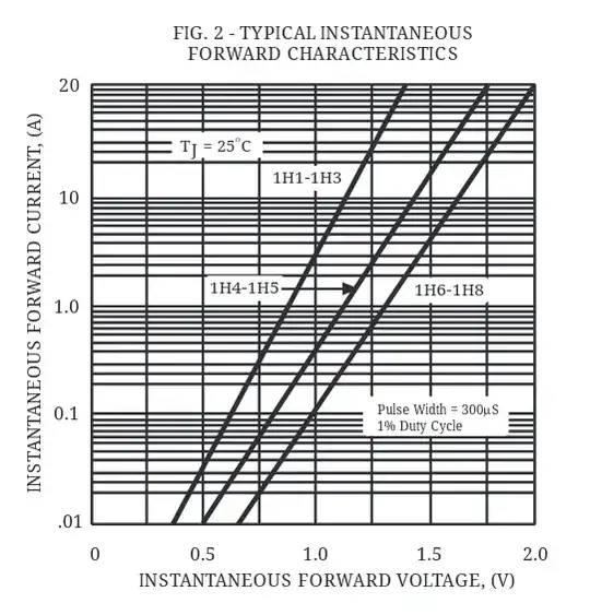

All the current answers focus on the diode equation - and that's fine. But if you have a specific diode in mind, you can look in the datasheet - practically all diodes will have the I-V curve in the datasheet. So just look at the graph and check at what current it will drop 0.7 V. Noe that this is still subject to tolerances.
Here is an example of a random diode found online. Looking at the graph, we can see that 1H4-1H5 will drop 0.7V at around 80 mA. (Thanks Tony for providing a better graph). Datasheet link
jaskij
  • 1,223
  • 13
  • Notice how the graph doesn't go down to 50 uA and that an exponential on a log scale shud start as a straight line. Notice how the graticules are not logarithmic. This looks wrong. I would expect better plots from a professional diode company. But I see better results on other parts https://www.dccomponents.com/upload/product/original/244596315940.pdf – Tony Stewart EE75 Aug 28 '22 at 16:58
    @TonyStewartEE75 edited to use the datasheet you found. – jaskij Aug 28 '22 at 17:36
