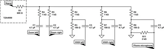

I have a TZA-4000 mixer-amplifier. It has a preamplifier output 200mV/600Ω.
I want to feed this output into several recording devices:
  • Zoom H1N audio recorder. It has a line-in/microphone input with input impedance of 2 kΩ. The manual says, "The H1N can supply plug-in power if the connected mic uses it." I don't know how it detects whether the connected "mic" uses it or not.
  • HC-X920 camcorder. It has a stereo microphone input, which provides 2.73V power. Microphone level can be configured -30..+12dB.
  • An Android phone, which is used for live streaming. Of course, it also provides some DC for the microphone.
Challenges that I see:
  • Level mismatch, which requires an attenuator for the phone. Zoom and camcorder have built-in input level regulation.
  • DC of the recording devices, which requires decoupling.
Questions:
  1. What is a proper way of splitting the source mono signal into three?
  2. How to deal with the DC provided by all the three recording devices so that it does not harm the source and each other?
Ideally, a complete circuit would be appreciated.

  • Have you tried with 1) a wire and 2) capacitors on each device to block DC? – Justme Aug 22 '22 at 14:40
  • Yes I tried using a headphone Y-splitter like this for Audio Recorder + Camcorder, and it works even without any capacitor. I'm just afraid it can ultimately harm something. 2) Not yet tried, I'm asking for a guidance here before ordering components and experimenting. I'd like to know the canonical/proper way of connecting devices in this scenario. My guess is to use a usual aux splitter (4 way), a capacitor on each line and an L-pad attenuator for the phone from https://electronics.stackexchange.com/a/620993/316022. But I'm waiting for experts' suggestion.
  • – AKd Aug 22 '22 at 17:16
  • Hi AKd. Don't screw around trying to jerry-rig something. There's pre-engineered solutions that cost very very little available. You'll be much happier with the resulting audio quality if you go this route instead. i.e. https://www.behringer.com/product.html?modelCode=P0386 as one example – Kyle B Aug 22 '22 at 17:53
  • Hi, @KyleB. Thanks for suggestion, it helped me know such devices exist. After looking into it, I see several disadvantages that prevent me from jumping at it. (1) it is active and requires power, which I'd like to avoid. (2) My topology would actually require two fork points: at the amp where Zoom recorder is located, and then at 10-15 meters away where the camera and the phone are located. (3) It amplifies the signal, whereas I need it attenuated. (4) Probably it does not have enough output DC resistance, so the phone will not detect it as a mic. – AKd Aug 22 '22 at 18:08
  • FYI, the "power" referred to at the beginning of your question is known as "phantom power". Its a 40-48V DC bias (and almost zero current) that's applied to the input wires, used by condenser microphones. Generally when that's available, the user has to push a button to turn it on/off as it can damage some (rare) types of microphones. Most dynamic mics can handle it no problem so often you'll see that set as "always on". Now that you know what it's called, you can easily google more information about it. – Kyle B Aug 22 '22 at 19:15
  • For the signal splitting, if you can not accept a powered solution like I pointed out, and you're adamant you want these things DC-isolated (good idea), the only option you have is capacitors. The problem you'll face is each input you want to feed will likely have a very different input impedance. That will affect the relative levels going into each, and also the frequency response is going to be affected (the DC-blocking caps and the input impedances combine to make a low-pass filter... i.e. if you insist on doing this with passive components, expect some negative affect on sound quality) – Kyle B Aug 22 '22 at 19:18
  • Zoom provides just 2.5V, not phantom power of 40V. It's for an electret microphone, I believe. Thanks for your inputs on the relative levels and low-pass filter, I read about this effect (actually, about high-pass). My audio is a lecture (speech), so I don't need descent hi-fi quality. Also, the impedance of the devices seems to be close to each other: 2K for the phone, 2K for Zoom and unknown for Panasonic Camcorder. I hope to cope with the filter by using a larger capacitor as described here: https://electronics.stackexchange.com/a/521902/316022. – AKd Aug 23 '22 at 07:32
  • @KyleB: The DC blocking capacitor and the input impedance of the devices will make a high pass filter - you'll lose low frequencies. – JRE Aug 23 '22 at 09:13
  • @JRE Haha --- True, my bad :) – Kyle B Aug 23 '22 at 15:39
