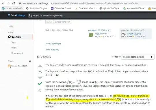

I was reading another question on EE stack exchange at link below:
Relation and difference between Fourier, Laplace and Z transforms
I read a sentence and I highlighted that sentence in attached snap. The sentence is:
Fourier transform F(jω) which is essentially the frequency domain representation of f(t)
So what does that mean? That a Laplace transform is not a frequency domain representation of f(t)?
