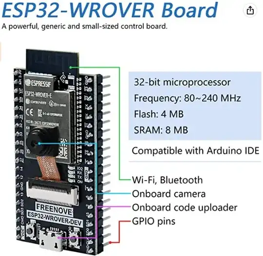

I am learning ESP32 and have a ESP32-WROVER dev board to work with. I have this board to work with and learn:
As part of my learning journey, I found that ESP32 has many edition, and the following editions are commonly offered to purchase on Amazon or Aliexpress
  • WROVER
  • WROOM

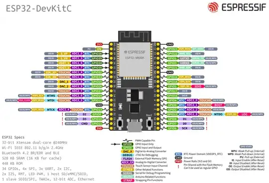

I found ESP32-DevKitC V4 pins here:
https://docs.espressif.com/projects/esp-idf/en/latest/esp32/hw-reference/esp32/get-started-devkitc.html#start-application-development
ESP32-DevKitC V4

  1. Considering that I am learning a WROVER DevKitC, how much of my knowledge will be applicable to WROOM?
  2. Is the code I develop for WROVER runs on WROOM when I don't use WROVER specific features?

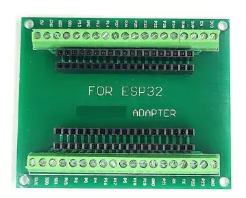

  3. Can I use the following Breakout Board for both WROVER and WROOM DevKits?
38Pin ESP32 Breakout Board for ESP32 Development Board

The basic difference between wroom and wrover is that the wrover has a serial ram chip. The serial ram chip is usually necessary when running a camera otherwise for general iot work, you don’t need the extra 8M of memory. As for programming they are identical.

  1. Virtually all of it; they are virtually identical except the WROVER dev board has a camera, a connector, and an extra processor for the camera.
  2. Yes 100%. However, now that WROVERs are almost or even as cheap as WROOMs, and you can simply turn off the extra processor to save memory and power, and they both have virtually identical low power modes, there is no reason I can think of to ever buy a WROOM kit again. In April 2023 you can get 4x WROVER dev boards with cameras for $25 on Amazon with free next day shipping.
  3. Yes, almost all espressif esp32 dev board pinouts are the same size (38 pins, like yours) but some people make shorter 30 pin versions, which seem rare, i.e. https://www.adafruit.com/product/5337. You will notice the WROVER dev boards almost all have a line next to every pin used for the camera (the camera will use them so don't use them for your own stuff if the camera is activated). Because anyone can make a esp32 dev board, you can't really be guaranteed the same pinouts, but 95% of board I have seen use the 38 pin package, with rare 30 pin versions. I've never personally seen anything else on a esp32 dev board.
