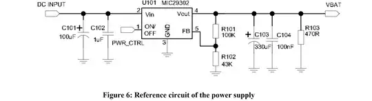

  • The SIM800 needs 4.2 V input, but transmitting causes a voltage drop and current bursts up to 2 A. For that I am using the power circuit given in the datasheet.

The SIM800 needs a 4.2V input. But while transmitting its causes a voltage drop and current bursts up to 2A. For that I am using the power circuit given on the datasheet.
It appears to require a voltage between 3.4V to 4.4V in which case it will at least not affect your choice of batteries and regulator like the MCU does.
Either way, I would consider letting it work on its dedicated power plane. Maybe use one regulator down to 5V and another down to 4.2V.
Overall you should consider the choice of voltage regulator. The one you have picked is adjustable but comes as a fixed 5V version as well. And then linear regulators aren't ideal for battery-powered applications since they have poor efficiency. If you wish to use one as clean reference for the RF part, which is a good idea for EMC reasons, then maybe consider a switch regulator down to 5V and a linear one down from 5V to 4.2V, to power that RF device. The Micrel part you've found seems like it would perhaps suit as the 4.2V one.
