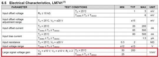

A real op-amp will have a gain around 100
Closed-loop gain - sure. Open loop gain - no. Not at DC. Any practical op-amp will have an open-loop DC gain of 10V/mV or more. Even the venerable LM741 has typical open-loop gain of 200V/mV: that's 200,000.
Table 6.5, Electrical Characteristics, from the LM741 Datasheet
Image source: Texas Instruments LM741 datasheet
Assuming an op-amp without an offset voltage, the closed-loop voltage between the inputs will be impossible to measure with cheap multimeters. 1mV of error (without offset) is a lot for any modern low-voltage op-amp.
Thus, a more realistic relationship would be $$V_p-V_n = 1.8/(50\cdot10^3) = 1.8/(5\cdot10^4) \approx \frac{2}{5}10^{-4} = 40{\,\rm \mu V}.$$
You'll need a decent multimeter to measure that. Or a preamplifier, with the offset trimmed out. Even precision and "zero offset" op-amps may have offset too high to amplify such a small voltage accurately without offset nulling.
