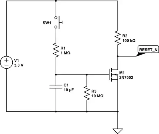

26
Once I did something sort of like this. It was more complicated because the button was actually the power button and had to work normally for short presses. The idea was to reset the microprocessor on a long press. We didn't want to rely on the microprocessor to implement it because the idea was to be able to recover if the microprocessor got hung up. It seemed to work well enough in testing. It went into production. But I don't have any way of knowing whether customers ever had to use the long press.

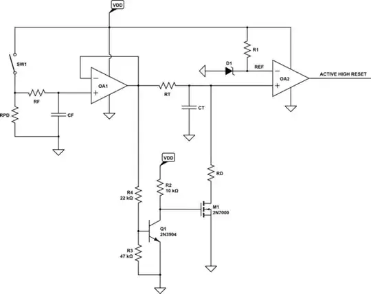

As JRE stated in their answer, MCUs or microprocessors manage the resetting process generally.
If your system has nothing for digital control then you can still go for analog implementations. The following is the one I designed in the past, for a remote reset signal:
schematic
RF-CF pair is a de-bounce and spike filter. RT-CT pair determines the timing. And there's a safe-discharge network (formed by the BJT-NMOS pair) to discharge the timing cap trough RD when the button is released, just to prepare the system for the next RESET quickly.
Rohat Kılıç
  • 33,940
  • 29
  • 85
    +1 for presenting an analogue solution. There are times when you don't really want a uC, also in some older electronics they were not available. This type of circuit (using 4000 series CMOS not opamps) was common in some well known analogue audio mixers designed in the 80's and 90's (damn I feel old). – danmcb Aug 03 '22 at 07:22
    Hi, can you tell me what's the transistor and mosfet network below doing? And OA2's purpose? – Meenie Leis Aug 04 '22 at 08:45
    @MeenieLeis the transistor-MOSFET network forms a safe discharger for the timing capacitor, CT. When the button is released the capacitor will be discharged through RD to prepare for the next reset quickly, in case the user wants to press the RESET switch again in a relatively shorter time. AO2 works as a comparator which tracks the timing capacitors voltage and generates a HIGH signal when it reaches to the reference voltage. I edited my answer accordingly. – Rohat Kılıç Aug 04 '22 at 09:02

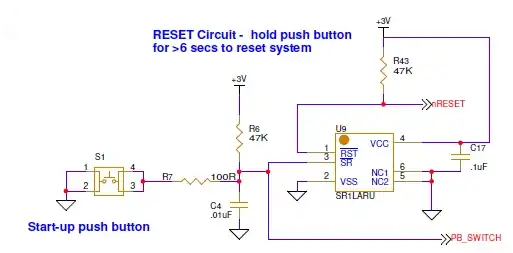

15
Use a Smart Reset generator such as the ST Micro SR1 family. That will generate a reset pulse after you hold the button down for a long (settable) time while the button acts normally for UI functions. https://www.st.com/en/reset-and-supervisor-ics/sr1.html
SR1 in circuit
Trust me, if you only have a software-implemented reset, you will be kicking yourselves during development at least as you have to open up the device and disconnect the battery to force a reset.
