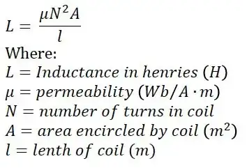

A ferrite bar has a great deal of leakage inductance, and makes a poor transformer at audio frequencies. You need much higher inductance to get sufficient impedance to match the output of your crystal radio. You would need many more turns to avoid loading down the radio output, and you would need a magnetic core with much higher inductance per square root of turns. From another answer:
Inductance formula
You would do much better with a simple transistor amplifier, but you could try using a small power transformer or modem transformer.
More information:
Why is inductance (L) proportional with turns-square (N²)?
https://www.learnabout-electronics.org/ac_theory/transformers02.php
