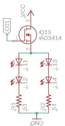

This is a part of my schematic:
Schematic
I want to turn on 4 LEDs with an Arduino. I tried doing this without a MOSFET but the output-wattage of about 2 W is way too low for driving all my LEDs (250 mW each). Here is the datasheet of the MOSFET I chose for now.
I'm not sure if this MOSFET suits my needs. The input to the gate (C01) comes from the Arduino, so 5 V. The VCC would be the same power adapter as the Arduino, so also 5 V, but with way more current available. Each LED would consume 20 mA of current according to the datasheet.
Would the AO3414 be suitable for this? The datasheet states it can handle 20 V, but I'm not sure if that means it can handle 5 V as well? The voltage from gate to source is ±8 V. Is 5 V still possible? If not, could you maybe suggest another MOSFET? If the voltage from gate to source is below 5 V, what would happen if I'd use 5 V anyway?

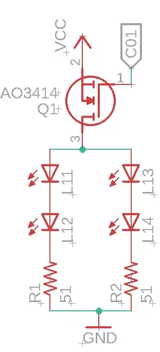

Edit: I changed the orientation of the MOSFET, would this setup work:
schematic v2

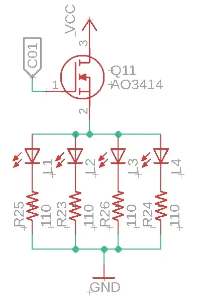

Edit: Since PStechPaul pointed out that the voltage drop is too much, I gave each LED a resistor. Would it be OK this way:
schematic v3
I calculated the resistance with this calculator.

    @TimWilliams please note that the OP is proposing to put an N-channel mosfet on the high side. So I don't think the schematic as shown is correct. It will not result in the mosfet being turned on. – user57037 Jul 24 '22 at 07:43
    Right now the MOSFET in your schematic is upside down (drain and source). – Lars Hankeln Jul 24 '22 at 07:44
    If you move the mosfet to the low side as winny suggested the circuit should work fine. With only 40 mA, you could use almost any mosfet as long as the Vgs(th) is low enough. You could also use an NPN BJT. The part you chose will work fine on the low side. – user57037 Jul 24 '22 at 07:45
  • @mkeith I edited my question and added a new schematic. Would this one work? – Cowboy_Patrick Jul 24 '22 at 08:00
  • It will not work (very well) with the NMOS on the high side and the LEDs on the source. The LEDs require about 1.5-2 volts each, so there will only be 1 or 2 volts for the gate. You would need a PMOS on the high side, or put the LEDs from Vcc to drain of the NMOS. – PStechPaul Jul 24 '22 at 08:07
  • What kind of LEDs, by the way? – Tim Williams Jul 24 '22 at 08:09
    I see that your white LEDs have a forward voltage of 2.6 to 3.6 volts. So you can't use two in series with a 5V supply. – PStechPaul Jul 24 '22 at 08:12
  • @PStechPaul so I would need a resistor for each LED? Right – Cowboy_Patrick Jul 24 '22 at 08:24

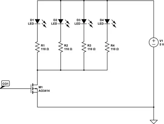

schematic
That MOSFET will work fine but you should put it on the low side between the LEDs and GND. Not only was it upside down (source/drain swapped) but it was also on the high side of the load when it should be on the low side of the load. After you build it, you can fine-tune the LED current by adjusting R1-R4. If the current is too high, use a larger resistor. If the current is too low use a smaller resistor.
Hope that helps.
