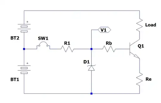

current regulator circuit

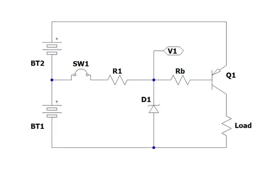

I want to build a circuit that supplies constant current to my load.
In theory, the PNP transistor is in its active state when the switch is closed. D1 and R1 will reach a stable point on the Zener diode's characteristic curve (e.g. voltage \$V_1\$, current \$I_1\$ across D1.)
This will supply a constant current (\$I_b\$) to the base, which will fix the emitter-collector current to a \$\beta\$ multiple of \$I_b\$ over a wide range of voltages. The reason I'm using a Zener diode is because BT1's voltage drops over time which will affect \$I_b\$.
I predict the current to the load to be: $$ I_{\text{Load}} = \beta \frac{V_1 - V_{\text{BC}} - V_{\text{Load}}}{R_b} $$
Can the Zener diode maintain a stable base current and regulate load current as expected?
Is it sufficient to determine \$V_1\$ by load line method using only BT1, R1 and D1, ignoring the rest of the circuit?

    The temperature coefficients of the zener and Vbe, as well as the part-to-part variation in beta and several other factors make this idea impractical. A better alternative would be a current mirror, and better yet an op-amp/bjt or FET current source. – John D Jul 07 '22 at 16:44
  • If you want a single BJT stage with a collector current as constant as possible you should be aware that the BJT is a voltage-driven device. Therefore, use a low-resistive voltage devider at the base (advantage: Base voltage nearly independent on the base current and its pretty large uncertainty) and use a current stabilizing emitter esistor RE. – LvW Jul 07 '22 at 16:59
  • @JohnD I read that beta can increase with temperature: https://electronics.stackexchange.com/questions/490868/will-a-bjt-blow-up-if-there-isnt-any-load-resistance-either-in-collector-or-emi, but there seems to be a way to counteract it by adding an ohmic load to the emitter. The resistor-zener series appears to be a standard circuit used for voltage regulation. As I see it, the zener diode circuit and transistor circuit work fine on their own. Is putting them together really so impractical? – coulombs Jul 07 '22 at 18:06
  • @coulombs With an emitter degeneration resistor you could improve the circuit. Since you haven't added any performance specs or requirements it's hard to comment beyond that. The early effect, the previously mentioned tempcos, and part-to-part variation if you're building more than one of these will all impact performance. – John D Jul 07 '22 at 18:47
  • @coulombs For constant current design using discrete BJTs, consider reading this. – jonk Jul 07 '22 at 19:37

This is your circuit redrawn. enter image description here It appears that you are trying to feed the base of the transistor with a Zener regulated voltage, the problem is that this voltage is referenced to the collector of the transistor through the variable load, when it should be referenced to the emitter through a fixed resistance.
In order to do that you could swap the emitter and collector, but to do that and keep the diode and battery polarities the same you would need to switch to an NPN transistor. You would also need to add an emitter resistor and move the load. Here is the circuit with those changes: enter image description here This will make it regulate the current much better than the original did (which was pretty much not at all) but it's got room for improvement.

  • The denominator in my equation is the resistance of the base resistor, not the resistance of the load, so our equations are different. Also, I should mention that my load is non-ohmic. I suspect that there might be some other mistake in my equation. Thanks for helping me check. – coulombs Jul 07 '22 at 17:47
  • The circuit diagram you made is different from the circuit I am asking about. Please refer to my original diagram and question. I appreciate your help, but you won't be able to provide a relevant answer unless you understand the circuit. – coulombs Jul 07 '22 at 20:50
The answer is "no". Zener can only fix the Base voltage.
If you give the value of BT1 and BT2, it is possible to show what one can expect ...
If you move the Zener, then one can expect a "constant" current.

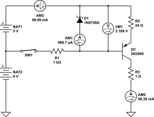

To convert base voltage to a current, you need a resistor in the emitter circuit. As follows:
schematic
No need for a base resistor.
R1 is the load for the 3.3V Zener diode D1, and the base load as well. R2 sets the current. R3 is the load.

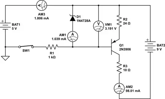

There's no need to split the supply voltages, although for now let's keep the split. The load current flows through BAT1. You probably want the load current flowing through BAT2 only:
schematic
simulate this circuit

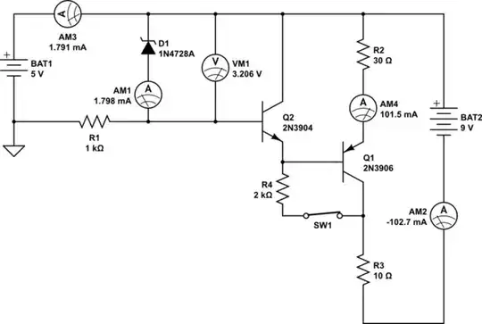

Now, the problem is that the Zener current through D1 depends on Q1's beta: the lower the beta, the more current flows out of the base, and less through D1. We should stabilize the current through D1.
We can add Q2 to decouple the Zener voltage from Q1's base. Even with beta variations, the base current of Q2 through D1 is so small as not to destabilize the Zener voltage much.

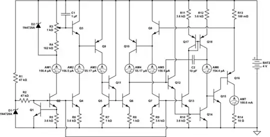

schematic
The circuit above operates with current stabilized to about 0.1% from 5V to 30V, and within 1% down to about 3.7V. Transistor matching should be unnecessary, although all NPN and PNP types should be respectively identical, with exception of Q16.
D1 stabilizes the current reference Q1-Q2. The stabilized current is then used to establish the Zener current through D2. R3-R4 is the reference voltage divider, establishing the current setpoint across the shunt R13. The reference current is used to bias the input stages of the differential amplifier, as well as a part of the output stage. To improve performance with discrete components, the current mirrors have strong emitter degeneration. The circuit is quite insensitive to slow changes in the load impedance.

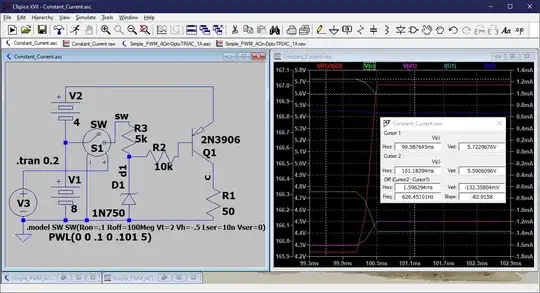

I'm not sure what is being attempted in @coulomb's circuit, but the zener will (to some extent) regulate base current and thus also collector current when the switch is closed. However, the only thing that does is drive more current through the zener diode, which will cause its voltage to rise slightly. The collector current follows base current according to beta, but that can vary considerably between devices, as well as temperature, voltage, and current. This might show some of the circuit's operation:
Circuit simulation
