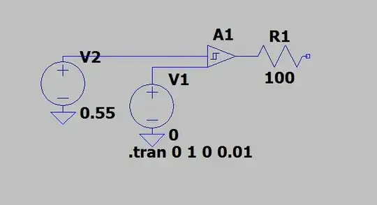

  • I checked an example, your answer is not true. The second input (in the gui) makes it act like a ground offset, so it effects input and output. – lalala Jul 05 '22 at 09:31
  • @lalala Can you show that example? – a concerned citizen Jul 05 '22 at 10:15
  • sure. edited the question – lalala Jul 05 '22 at 10:18
    @lalala That's not an input, that's the ground (the 8th pin. As I said, and repeated, check the netlist. Add names, for better viewing, but check the netlist. You'll see that the connection to the bottom pin appears as the 8th pin. Then, if you'll aslo check the manual under LTspice > Circuit Elements > A. ..., you'll see which pins are what (the very first paragraph). And the reason the 8th pin is visible is for those cases where a floating ground is needed, because, as you'll read in the help, when not connected, it defaults to net 0 (zero, or GND). – a concerned citizen Jul 05 '22 at 10:22
  • Thanks. Netlist says A1 N001 N002 N002 N002 N002 N002 P001 N002 SCHMITT, will try to change the names then post again – lalala Jul 05 '22 at 10:27
  • Yes: A1 Source Goff Goff Goff Goff Goff out Goff SCHMITT with Goff the at the ground. The first paragraph says: "Current is sourced or sunk from the complementary outputs, terminals 6 and 7, and returned through device common, terminal 8." Thanks. Now it is clear that 'device common' is a word for 'element ground' – lalala Jul 05 '22 at 10:32

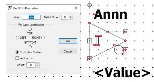

The bottom connection is ground.
Digital circuits in LTspice are special and comes with limitations since they appear ideal, can source and sink infinite current without consuming anything and will only have the parasitic you give them. Upside of this is extreme speed advantage.
I have not found any official documentation stating that the bottom connection is ground, but if you edit the symbol or look in the netlist, you will see it's called COM, for common.

    "I have not found any official documentation stating that the bottom connection is ground" -- quote from the manual, LTspice > Circuit Elements > A. ..., 2nd §: "Current is sourced or sunk from the complementary outputs, terminals 6 and 7, and returned through device common, terminal 8.". The picture you're showing has com as the label of the pin, becuase it doesn't make sense to say gnd since it's meant to be used either grounded or floating, e.g. a reference for the other 7 pins. Like a VCVS, for ex.: just because the - pin is grounded usually, it doesn't mean it's the ground. – a concerned citizen Jul 05 '22 at 15:01
    @aconcernedcitizen Good find! – winny Jul 05 '22 at 15:17
