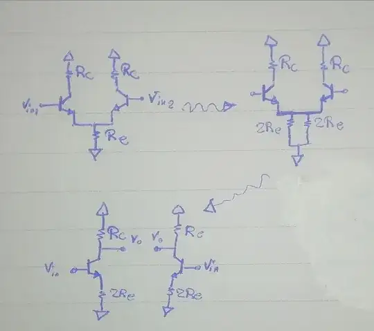

Common mode Gain
Since our excitation is symmetrical, the two symmetric sides of our circuit will function exactly similar.
As a first step, we can change \$R_e\$ with two parallel resistors with value \$2R_e\$. (Note that the equivalent value of two parallel \$2R_e\$s, is \$R_e\$)
Now here is the important trick. Because of our symmetrical inputs and symmetrical circuit, the voltage of emitter resistors will be identical even if there is no wire between emitters of BJTs. So we can easily omitt the middle connection between two sides as depicted below: common-mode equivalent circuit
And at the end, we have a simple common-emitter gain stage, with emitter degeneration resistor \$2R_e\$. Gain is simply $$ \frac{V_o}{V_{in}} =- \frac{R_c}{r_m + 2R_e}, r_m = g_m^{-1}=\frac{V_{thermal}}{I_c}$$
where \$I_c\$ is bias current passing through collector.
