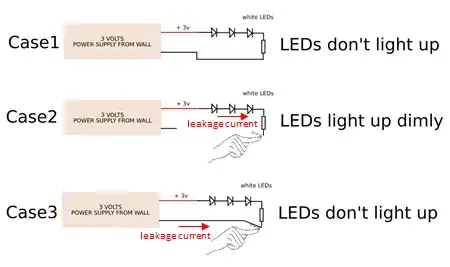

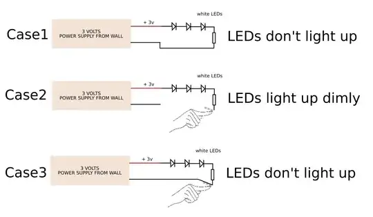

Case 1: The LEDs don't light up since the applied DC voltage, for three of them in series, is as low as or even lower than the forward voltage of one of them.
Case 2: The LEDs light up dimly on account of the small capacitive leakage current from the mains,through your body, to ground. It's apparent that the power supply is not earthed through the third pin.
Case 3: The LEDs do not even light up dimly since the capacitive leakage current to ground bypasses the LEDs, through the negative terminal of the power supply.
