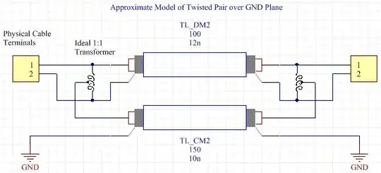

Basic Twisted Pair Model
Model the cable as two transmission lines: one representing the differential mode (signal to GND wire), stacked on top of one representing the common mode (GND wire over GND plane). For coax over GND, this is a reasonably direct model; for twisted pair, use ideal transformers at either end to place the CM mode at the midpoint of the DM ports (this version is shown above).
The signal couples into CM corresponding to wavelength versus electrical length, exhibiting notches in the frequency response at harmonics, corresponding to maximum coupling and thus CM emissions/susceptibility (which aren't necessarily an overall problem, for example the cable or system can be shielded overall; but if it is exposed, then it's a prime suspect).
So in short, it's good when the signal bandwidth (signal bandwidth or pulse risetime) is short or on par with cable length, i.e. at frequencies where the coupling is not excessive.

  • Thanks for the reply. I +1'd all answers here, but can't decide which to accept. I'm tempted to accept this one but I'm having a hard time understanding it entirely. Would you mind adding schematics to illustrate what you are saying? – user42875 Jun 27 '22 at 14:36
  • @user42875 how's this? – Tim Williams Jun 27 '22 at 19:38

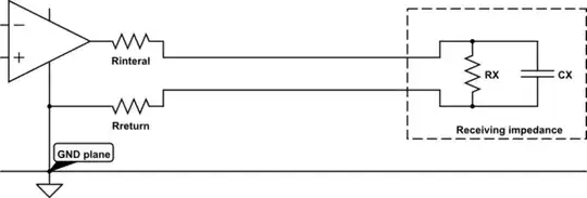

Ground planes are good dump-and-forget nodes for return currents at both high and low frequency because they are present everywhere on the board. But the issue comes when using it as return for precision single-ended signals, because any local change in the plane's potential will add to the measured signal amplitude at the receiver - bad.
The solution
Make the single-ended signal differential by adding a second dedicated return conductor to it, which can be also at ground potential
schematic
The trick herein is that all low-frequency signal return currents for this signal will flow in the new conductor and all other return currents will not flow in this conductor. By adding Rreturn, one can even match the impedance of this wire to be similar to the signal sender's.
Potential noise from the GND plane and other sources would impact both traces similarly, highlighting the benefit of the differential signaling.
These benefits in signal integrity only come to fruitation when the receiver is differential. If you have a single-ended receiver, referenced to its local ground, then the signal integrity will not improve as much vs. omitting the ground wire. However, even in this case, having the ground wire close to the signal wire strongly helps with EMC because the return current loop size is essentially zero.

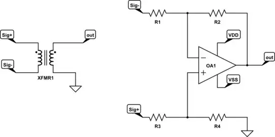

Differential receiver
The receiver doesn't need a reference to its local ground, i.e. it can be floating. Still, it must be assured, that the differential signal is still within the receiver's valid common-mode input voltage range.
Below are two examples of differential-to-single-ended receivers. The transformer approach on the left has very large input common-mode voltage range, limited only by its isolation strength. It can be used for HF signalling because then the transformer doesn't need to be so big.
The op-amp approach on the right is more common for low-frequency precision signalling because it works down to DC. The common-mode voltage range is limited by the supplies (or a multiple of them depending on gain). Therefore, the op-amp supplies must be referenced to the same ground as the sender, even if only by large 1M resistor to prevent the sender and receiver from floating too far apart.
schematic
