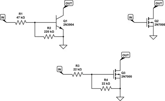

If we call the potential you use to control your switch "IN", and the node to be pulled down "OUT", any of these will do:
schematic
Q1 will connect OUT to ground if IN exceeds about +0.8V. That will be the case regardless of which bipolar transistor you use. Q2 would pull OUT low when IN exceeds about 2V. The MOSFET you choose will decide the actual switching thresholds.
Q2 might not like a control signal "IN" higher than +20V or so (or lower than -20V), depending on your choice of MOSFET. You can "scale" IN down with a resistor divider, if there's a chance that the potential at IN might lie outside of the MOSFET's comfort zone. The bottom version protects Q3's gate using resistors to divide IN by 2. For this reason, Q3 will require IN to be 4V or more to switch on.
Note that there's no need for +24V in any case.
The bipolar junction transistor (BJT) Q1 will not work to "pull up" a negative potential at OUT (OUT must be floating or positive), but the MOSFETs can do that. The MOSFET behaves more like a physical switch than a BJT.
Q1, being bipolar, cannot pull OUT all the way to ground. It can get within 0.2V or so of ground (0.1V if you're lucky), but the MOSFETs will perform much better in this respect.
The top-right implementation is attractively simple, but be aware you may never leave a MOSFET's gate (IN) floating. There must always be a potential explicitly applied there. That means a simple switch from IN to +10V (for example) will not work, because the gate will float when the switch is open. The other two (top-left, bottom) do not have this problem.
If OUT is unloaded, as you suggest is the case, all of these transistors may leak enough current to pull down OUT even when they are "off". They are not perfect on/off switches. Without knowing more about your application, it's not possible to say what measures need to be taken to solve this issue.
Simon Fitch
  • 34,939
  • 17
  • 105
  • Thank you! I almost get it. (It's sad to be this dense!) Question: Does your Q3 example warrant the same warning as you gave for Q2, i.e.,, don't leave MOSFET gate floating? Or does R4 hand that, even when IN is open? By the way, the "floating" OUT that I want to pull to ground is a TTL logic circuit signal which does whatever when polled low. I know you said there is no need for +24v, but the only lines available to me are 1) +24v, 2) ground, and 3) the TTL-level floating OUT + a switch to trigger the MOSFET's gate. – CuriousOne Jun 19 '22 at 03:51
  • @CuriousOne Resistor R4 does indeed prevent Q3's gate from ever floating. You may use a switch between IN and +24V, knowing that R4 takes care of the "open" switch state. These circuits work with any source of potential difference between ground and IN. If the voltage source you have is +24V with respect to ground, and that's all you have, then you may apply that potential directly to IN (via a switch, if that's your intent) in both Q1 and Q3 implementations. – Simon Fitch Jun 19 '22 at 04:07
