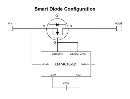

While continuing a research on the topic, I've stumbled upon this chip: LM74610.
So, here is a simple answer: yes, it is absolutely possible to make 2-terminal "ideal" diode. Note the term in parenthesis denoting the usual approximation of the theoretical abstraction.
Not surprisingly it works by harvesting energy of the load current, just as @Kubahasn'tforgottenMonica suggested.
The chip requires only external MOSFET and a storage capacitor to work inline. The FETs are routinely embedded into PMICs (see LM66100 for example). I suspect capacitor can be embedded as well, or at least bonded to the die in production. This makes a single 2-terminal device perfectly plausible and not too expensive or hard to manufacture.

    This circuit has a periodic >0.7V glitch to recharge the boost capacitor. Not quite ideal, but, it is a clever circuit. I'd rather stick with the circuit @Ste Kulov referenced in the comments of your original post due to simplicity and that it can be used above 45V reverse voltage limitation the LM74610 has. – qrk Jun 16 '22 at 21:58
    So what is the voltage from Vin to Vout during operation? Does the circuit require an ideal MOSFET in order to function as an ideal diode? – Elliot Alderson Jun 16 '22 at 22:51
    @ElliotAlderson Either ideal MOSFET or a pinch of fairy dust :) The way I understand datasheet, the gate is switched off with 2% duty cycle, which increases voltage drop to that of a body diode, allowing charge pump to steal some power. The rest 98% of time the voltage drop is defined by Rds(on) of the MOSFET. – Maple Jun 16 '22 at 23:12

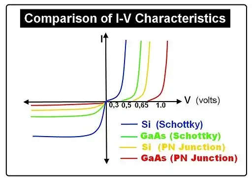

No, there are no ideal diodes, just as there are no other ideal elements but you can use a diode with a lower drop.
enter image description here Source: https://pediaa.com/difference-between-schottky-and-zener-diode/
