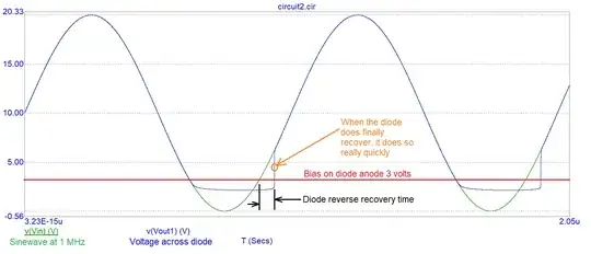

For instance, in simulation, I apply a 1 MHz sinewave biased up at 10 volts (green waveform) to a diode whose anode is at 3 volts. The sinewave voltage is fed via a few ohms for current limiting: -

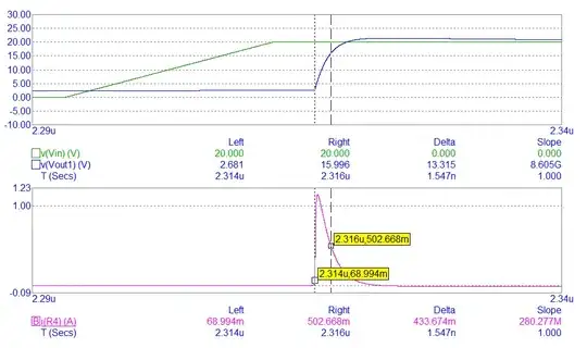

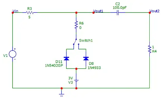

The blue waveform is the diode voltage and, you can see (highlighted in orange), it takes a while to recover but, when it does recover, it "snaps back" pretty darned quickly. And if I used a pulse (with moderate rise and fall times instead of a sinewave) I can get improvements in the current delivered into a 1 Ω load via a 100 pF capacitor: -
The above simulation uses ideal wires to connect things hence, I'm only showing its "results" as a way of demonstrating the potential fast snap-back time of sloppy old diodes.
Here I can get a 1 amp pulse of about 1.5 ns duration and about 100 ps rise time. But, do I really believe it? There isn't anything in the data sheets for these types of diode that indicate what the snap-back time is.

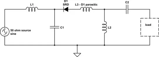

The topology of this circuit your are testing is unusual for a SRD, as it involves such low impedances, and ignores some key parasitics.
Usually, when we come to build a circuit physically, the L/C ratio of the unavoidable parasitics will tend to push us up into the 10s to 100 ohm range, and 1 ohm loads will be out of the question, especially in the face of a few nH series L in the switching diode.
This is the sort of basic circuit that is more typically used and analysed.
schematic
During the charge stage, current flows from the source through L1, D1, L2, storing charge in D1.
During the discharge phase, current flows back out of the diode, through L1 and L2, storing energy in L2.
When D1 snaps off, the interrupted current in L2 generates a voltage that goes through C2 to the load. The now low self capacitance of D1 means that L3's energy does not couple significantly to the output. Additional biassing may be used to time the snap off to occur at the peak discharge current.
