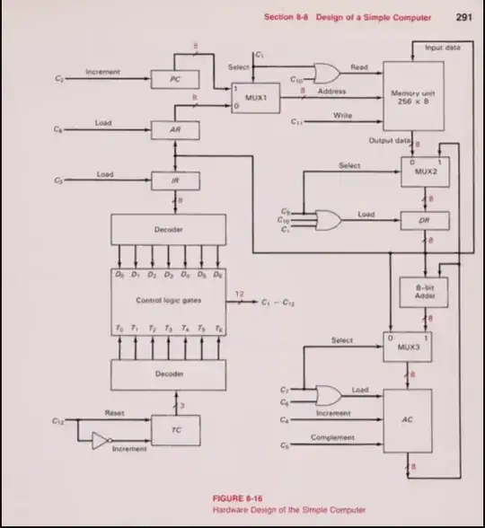

I have recently started studying computer organisation and found that in most of the books the design of computer system is not discussed beyond functional design abstraction level (as shown in the figure)
I want to know what is the procedure to physically implement functional design of a entire computer system (cpu+memory+I/O+system bus) into actual hardware (PCB)?
Thanks!
Fig. functional design of a computer (just for illustrative purpose)

  • I got your point. Indeed these days cpu are built up on chips which are further integrated on circuit board. I am aware of the chip design process where specs are entered via HDL and simulated to generate an RTL schematic which is further logically synthesised to generate a gate level net list which acts as an input for physical design followed by partitioning, floorplan etc to generate the desired chip. But I am not sure of the pcb design flow, how functional description of computer system consisting of modules cpu, I/O memory are synthesised into a physical circuit. – partykid Jun 06 '22 at 15:59
  • @partykid Basically by elaborating the details over and over until you get to the circuit level. So your diagram has a section marked "control logic gates". Figure out what those gates are and draw a new diagram with the gates. Let's say you have a bunch of AND gates. Find an AND gate chip that you like, research them, and draw a diagram showing how the gate chips are connected, instead of the |_) symbol. Now figure out how to arrange them on a circuit board for short connections, and copy over the connections. There are, of course, tools to help with every step of the process. – user253751 Jun 09 '22 at 13:32
  • @partykid of course you do not need to draw every single diagram as long as you can visualize it in your head. Many people wouldn't draw a schematic diagram showing the logic gate chips, they'd go straight from gate diagram to circuit board. – user253751 Jun 09 '22 at 13:34
  • @partykid and you can ask questions about one specific step you are confused about. – user253751 Jun 09 '22 at 13:34
