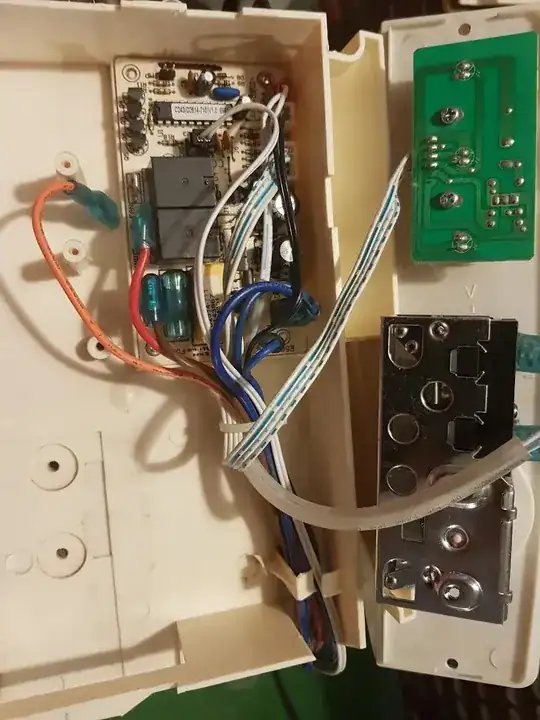

I disassembled it a bit and it turned out that the compressor is working, but the fan is not starting up, and the ugly noise coming from one (or two) relays.
The relays are on a small panel along with IC, transistors, capacitors etc.

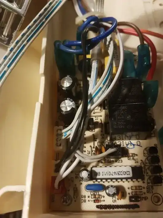

The noise is coming from the black boxes.
I disconnected the orange (fan) wire from the panel.

    One cause for the problem might be a faulty capacitor. The one that is bulging. – Justme Jun 05 '22 at 18:33
  • Thank you for noticing on the photo what I have not noticed with my own eyes! I will start with replacing the swelled capacitor. – riskop Jun 06 '22 at 05:40

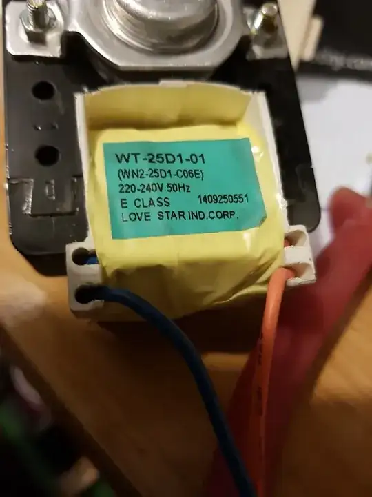

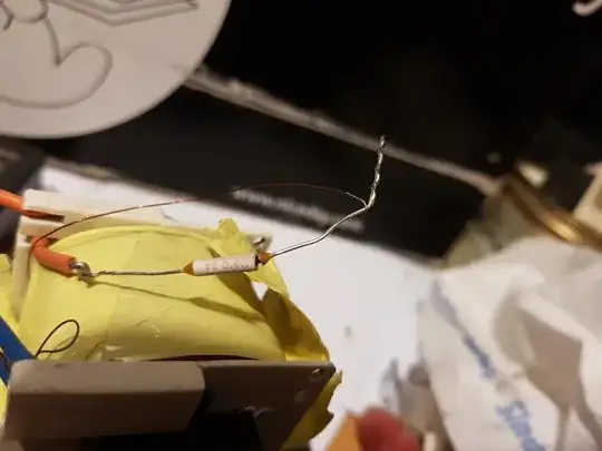

I replaced the bulging (and for safety s sake the other too) capacitor and the relay (s) stopped making noises, and 230V appeared on the "cmp" and "fan" pins. The compressor started up, but the fan not. I measured infinite resistance on the fan motor. I disassembled the fan motor a bit and it turned out that a thermal fuse was glued to the winding and it was broken. After fixing that everything started up.
I guess that after the capacitor broke down, the fan stopped working but the compressor not, overheating the motor and breaking the thermal fuse.
