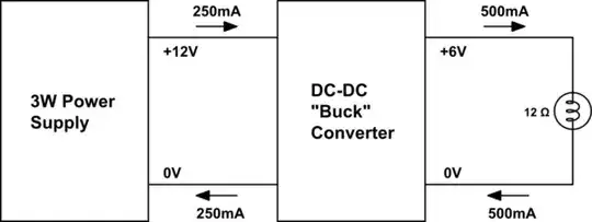

In our example of a 12V power supply, limited to 250mA (for a maximum output power of 3W) and a lamp requiring 6V at 500mA (also 3W), you could use a "buck converter", otherwise known as a "step-down DC-DC converter", in the following configuration:
schematic
Here you can see that the power supply is providing 250mA, which it is quite capable of, but the lamp is drawing twice that, 500mA! Crucially, the power being provided by the power supply, and power being delivered to the lamp are both 3W:
$$ \begin{aligned} P_{SOURCE} &= V_{SOURCE} \times I_{SOURCE} = 12V \times 250mA = 3W \\\\ P_{LAMP} &= V_{LAMP} \times I_{LAMP} = 6V \times 500mA = 3W \\ \end{aligned} $$
We can conclude that this power supply is able to operate the lamp, but we will have to use an intermediary to bridge the different conditions of supply and demand.
If you are wondering how it's possible to get more current than 250mA, from a source limited to 250mA, I remind you that the only physical law that needs to be obeyed here is the law of conservation of energy. There's no law called "conservation of current". The means of achieving this current-boost and voltage-buck behaviour are complex, and I encourage you to study "DC-DC converters" and their counterparts "linear regulators", to understand this better.
In this example I have assumed a 100% efficient buck converter, which is of course impossible. Nothing is 100% efficient in real life, but the principles here should be clearer now.
