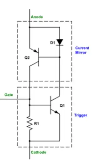

This seems to be a good low-parts-count solution using BJTs, but FET's are preferable. enter image description here https://electronics.stackexchange.com/a/344346/65001

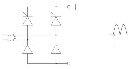

My application is a thyristor-controlled rectifier with an isolated SMPS. enter image description here https://www.ppi-uk.com/news/thyristor-controlled-rectifiers/

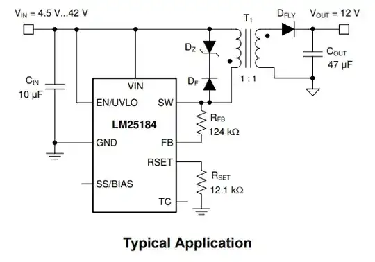

Here's the isolated SMPS i'm trying to current-limit. I want to use a thyristor in place of Dfly. enter image description here

    ""to pass in a graduated manner, by firing (switching on the thyristor) at a precise time, therefore controlling the conduction angle."" If you truly mean passing current in a graduated manner, this will fry your device. No current through + high voltage across (blocking) = no power dissipated. Moderate current through + low voltage across (conducting) = low power dissipated. Moderate current + moderate voltage across (graduated current)= fried device. That's why we really try to only use linear for low power and try to use switching for high power. – DKNguyen May 21 '22 at 04:20
  • @BruceAbbott I've remove stuff about rectifiers and SMPS. Application doesn't matter. The question now is simply, " Is it possible to emulate thyristor behavior at Mhz speeds?" – johny why May 21 '22 at 04:20
    Which behaviours of the thyristor are you after? Ability to block current in both directions? Only able to conduct current in one direction? Latching once conducting? – DKNguyen May 21 '22 at 04:21
  • @DKNguyen I may be wrong, but i believe a thyristor IS a switching device, not a linear device. SCR's and Triacs are used to high-current light-dimming applications. – johny why May 21 '22 at 04:21
    Yes a thyristor is a switching device only which is why I was confused when you said "graduated". The light is dimmed, but the current isn't actually graduated. More like it's being chopped up rather than throttled (which is what I interpret graduated to mean). – DKNguyen May 21 '22 at 04:22
  • Yes, i believe it's chopped up. The word "graduated" was a quote from the article i linked. – johny why May 21 '22 at 04:25
  • Why do you think you need a thyristor? Why do you think you need thyristor behavior? SCRs and Triacs were the 'go-to' option for high current light dimming in the previous century, but we're moving on from that because they're not a useful at high frequencies. I strongly suggest you edit your question to describe your application in more detail, without presupposing a solution. Perhaps the answer you're looking for is something like 'synchronous rectification', but it's hard to say without more detail. – brhans May 21 '22 at 11:39
    Based in the above circuit, it is controlled rectifier. Thyristors still work there. To get more MHzs, it is necessary to build it on non-saturated devices without internal positive feedback, like power HF MOSFET or Schottky-FET, or even BJT, but with anti-saturation circuit. – Vladimir May 21 '22 at 13:32

  • Also - you can't just slap a full-bridge rectifier (thyristor-controlled or not) on the output of a flyback converter. That's not just a transformer being fed with a high-frequency AC sine wave. – brhans May 22 '22 at 01:19
  • @brhans The converter i'm using is isolated. It already has a rectifier designed into it, Dfly. i want to use a thyristor in place of Dfly. – johny why May 22 '22 at 14:19
  • @johnywhy What's the advantage of using a thyristor there? – Hearth May 22 '22 at 14:31
  • You can't do that to a flyback converter - and particularly not that one which samples the flyback voltage in order to regulate its output. – brhans May 22 '22 at 14:32
  • @Hearth current regulation or limiting – johny why May 22 '22 at 14:59
  • @brhans "one which samples the flyback voltage" - Why? – johny why May 22 '22 at 15:00
  • Flyback converter is a current source by its nature (more precisely, it is power source). Output power is limited by magnetic flux energy, stored in transformer core at each period. If you need more accurate current regulation, then you should measure current (with shunt for example) and feed it back to controller. – Vladimir May 22 '22 at 20:14

Yes, you can. It will be as fast as the BJTs you use.
You can replace D1 with a resistor.
The choice for the resistors gives a tradeoff between turn-on ease and turn-off delay.
Turn-off is limited by recovery from deep saturation of the 2 BJTs. A Schottky diode or even a Baker clamp could be used, but a) the Schottky diodes would need to be able to carry most of the total current, and b) a Baker clamp would increase the on-voltage.
Note that the BJTs operate with a forced beta of about 1, so they need to have a base current rating of this - this is not commonly specified and may be lower than expected (compared to specified collector current.)

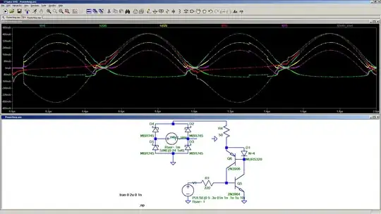

Here is a quick simulation.
The BJT pair drops 2V at 0.5A and you must derate the 1W shared dissipation here and cannot use a TO-92.

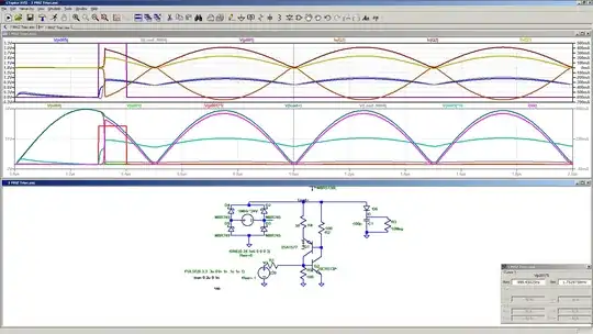

See below using 24Vp 1MHz with 50 Ohm load.
Another demonstration shows it triggers by itself with 0V input unless Vbe is shunted by 100//220, then once triggered, it won't switch off due to junction capacitance between C-B's.
Note that Vbe rises to 0.9V ( scaled *10)

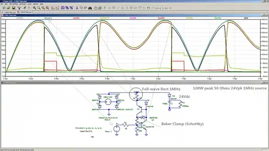

Then @jp314 reminded of the Baker clamp and I got something working for 1 cycle using two (2) 0.1 uS pulses delayed 30 degrees with the rectified 24V 100W 1MHz power source.
Conclusion
The better solution to this hypothetical problem is to define the loads, voltages and currents and consider a Dual half-bridge IGBT or FETs.
Additional comments
Q1 NPN gets the higher Vbe so PNP Q2 base and diode shares very low power.. That diode doesn't make much difference to guarantee cutoff. The Schottky diodes makes a huge difference. Also the NPN base resistance conducts a great deal of power and must be beefed up accordingly, unlike heavily doped discrete parts with tiny BE junctions.. You may examine the NPN Base current in my simulation it's alot more than the typical 10:1=Ic:Ib and depends on Rbe.
The PNP B-E resistor vs diode argument was considered in my simulation and I found no performance enhancements . But the Baker Clamp to prevent saturation capacitance reocvery times is essential for the discrete attemp.
This design idea is not recommended to attempt except for personal experience. Examine the simulation to save time.
