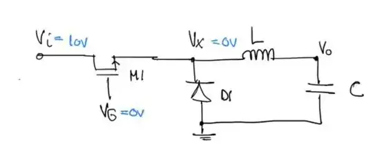

I know that to use an NMOS as a high side, you need a gate boosting circuit! I am just here to check my understanding on what WOULD happen if I did use an NMOS device without a boosting circuit and how exactly the transient turn on behaviour would work:
Off-State
In this state, Vi is 10V. Vg is 0V. Vx is also at 0V because the inductor acts as a short and the capacitor we assume is fully discharged, hence 0V appears at Vx.

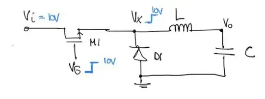

Turning On
We now apply a 10V step to the gate of M1. The Vx node was previously at 0V, so as the 10V to the gate of M1 is ramping up to 10V due to a finite rise time - first, a weak inversion layer will be created in M1 channel, a sub-threshold current will begin to flow through M1 and node Vx will be at 10V, turning the device off again?
This is where I am confused. How exactly does Vx get to 10V so that M1 turns off again? Could someone explain to me how much current flows, and the sequence in which things happen here?
Because I know if Vx is at 10V and Vo is at 0V, then the inductor should have a di/dt of 10/L but surely M1 cannot support that much current if it is in sub threshold, so what happens?

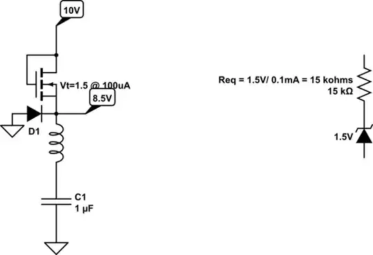

All FETs are defined in datasheets with Vgs=Vds = \$V_{gs_{TH}}\$ a.k.a Vt as the threshold voltage at some tiny current like 100 uA.
This is what your circuit looks like in this question.
schematic
Thus your C would charge up to 8.5V = 10V - Vt in milliseconds instead of microseconds.
Due to the square law in reducing RdsOn, for logic level FETs you need 2x Vt and older standard FETs with Vt= 2 to 4V with 2.5 to 3x Vt to achieve rated RdsOn.
