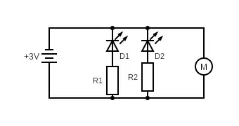

I have a simple motor and two LED toy with different color leds:
LED D1 is blue blinking listed as 30mA/3V/0.09W (osub5x31a), LED D2 is red blinking listed as 20mA/3V/0.06W (OSHR5X31A). Battery is 2xAAA.
These are numbers the seller gives in homepage, but product detail sheets seem to have different voltage, so I'm a bit lost with that.
https://data.oomipood.ee/kasutusjuhend/oshr5x31a.pdf
https://data.oomipood.ee/kasutusjuhend/osub5x31a.pdf
Motor is rated as 1.5V-3V, I don't know other parameters.
I cannot figure what values R1 and R2 should have, or how to calculate them.
I initially made it without any resistors, but then the red LED barely works (does not blink,) blue does not light at all and motor works fine. References I found talk about 'voltage drop' but I'm not sure what it means, the LEDs I have don't list such property.
Update: hen I just connect the LEDs to the 3V source in parallel, no motor and no resistors, then they both seem to blink fine. Maybe they don't really need resistors at all, or is this not safe?

  • Welcome to EE.SE! That's because the red LED will clamp down your battery if you are not using a series resistor, and possibly damage the red LED. There are plenty of LED resistor calculators online. I=(Vbatt-Vf)/R. With your blue LED having the same forward voltage as your battery, brightness will depends heavily on the battery voltage. – winny May 12 '22 at 15:15
  • thanks @winny I did not find online calculator for such case, only for simpler cases with single LED. Is motor element here irrelevant really? And what would be "Vf" in my case - thats also something I could not put to the online calculator – JaakL May 12 '22 at 15:30

  • Checked these also, they seem to assume you have quite professional equipment, like lab power supply etc. I tried with my cheap handheld multimeter, which does have diode check. But: with blue LED it just keeps showing "1" (just as when disconnected), with red one blinks between "1" and seemingly random numbers between about "1400" and "1900". LED itself blinks while connected. Maybe it has some extra internal elements for the blinking, just to annoy me? – JaakL May 12 '22 at 16:40
Those are not simply LEDs. They are LEDs with an integrated circuit in an LED housing.
They are meant to operate on 5V. Your 3V power supply is not enough.
Without the motor, the battery voltage is (just barely) enough that the LEDs can operate
When you connect the motor, the battery voltage drops a bit and the LEDs quit working.
You need a higher voltage power supply, and it probably needs to be able to supply more current than AAA cells can deliver.

  • I tried finally with both 3V and 4.5V (3*AAA) power, no resistors, and no visible difference: without motor LEDs blinks fine, with added motor motor itself works, blue LED is blind totally and red LED shows very little light. – JaakL May 12 '22 at 19:06
    Like I said, the AAA batteries can't supply enough current to the motor. The motor draws so much current from the batteries that the voltage drops to something lower than the LEDs need. – JRE May 13 '22 at 09:44
These are blinking LEDs, they contain the circuitry to make them blink and current-limiting circuitry. So they don't need (or want) series resistors.
The bad news is that you must give them a voltage within the recommended range to have them reliably work. 4.5 minimum to 6V maximum. So they will work reliably from a 5V regulated supply. In parallel, no resistors.
