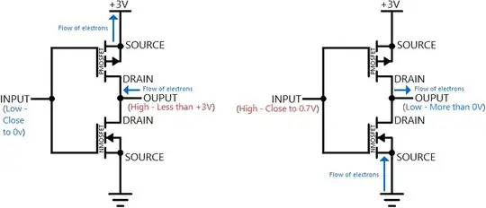

For now I'm interested in learning why the very simple NOT gate (inverter) is designed with 2 CMOSFETs. Just conceptually, not the math of it (if that's possible). Why not just one PMOSFET (P-type MOSFET)? Like this...
My thought is, either there is no (or negative) input and therefore a high flow of electrons from the output (1), or there is an (positive) input and there is no (or very little) flow of electrons from the output (0). Either there is high voltage in a closed circuit or there (almost) isn't. I assume the output is connected to the gate of another CMOSFET, like in a semiconductor chip, so I'm not sure how the output would be floating.
I think there's something I'm not understanding... Every contribution and/or explanation is appreciated.
EDIT: This is what I've concluded after the discussions in the comments and reading hacktasticals answer.

    Your output is always connected directly to ground. That's not a not gate. – Hearth May 07 '22 at 16:34
    Also, CMOS does not refer to a specific type of MOSFET; there is no such thing as "a CMOSFET". It just means the circuit consists of pairs of P- and N-channel devices. – Hearth May 07 '22 at 16:36
  • https://en.wikipedia.org/wiki/PMOS_logic you can do it that way, and it was used commercially back in the 60s, but it has a pile of disadvantages. – hobbs May 07 '22 at 16:41
    Your circuit shows a p channel mosfet connected backwards. What would make slightly more sense is a n channel, but you would need a notional resistor as a load. Also note referring to electron flow is fine when you are discussing the physics, but when discussing electrical operation, we’d normally use voltage and current. – Kartman May 07 '22 at 16:44
    @Hessi-Dude Your output is still connected directly to ground, though the MOSFET is no longer backwards. – Hearth May 07 '22 at 17:53
  • @Hearth - Sorry about that, just corrected the schematic. So for this to work I'd need a resistor between the output and ground? Btw. I thought the second line of the post would indicate that I know it's complementary metal oxide semiconductor field effect transistor, which means a good mix of n-channel and p-channel MOSFET transistors. I thought it would be easier to write CMOSFET so people knew that I know it's a mix of both, hence my apology for my poor use of terminology. – Hessi-Dude May 07 '22 at 18:20
    @Hessi-Dude But "CMOSFETs" is not a word anyone uses, CMOS is a description of a type of logic. And yes, if you add a resistor between the output and ground, then you've just made a PMOS not gate. PMOS and NMOS were common in the past due to some minor advantages they had over CMOS at the time, but CMOS has now blown way past them in pretty much every respect. – Hearth May 07 '22 at 18:27
  • @Hearth - You're absolutely right. Just thought "CMOSFETs (Complementary MOSFETs)" explained what I meant. Thank you for the help this explains the point with floating output. Just to be clear.... the higher/bigger the resistance the better... right? Or "even better"... don't connect it to GND. – Hessi-Dude May 07 '22 at 18:33
  • @hobbs - Apparently, not exactly that way. I missed a resistor. :-D – Hessi-Dude May 07 '22 at 18:34
  • @Kartman - Sorry about that, just fixed it. I know regarding voltage and current, but thanks. I just need to understand it with "flow of electrons" also for it to make sense in my silly brain. As it is now, I would need a resistor between output and ground.

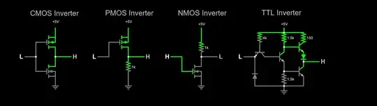

The ‘C’ in ‘CMOS’ means ‘complementary’. CMOS uses both P and N FET types that work with opposite polarity.
A CMOS inverter (P source to +V, N source to GND) works much like a single pole double throw switch. With a high input, the n-FET is on, connecting GND to output. With low input, the p-FET is on, connecting +V to output.
(try it here.)
The neat trick with the CMOS inverter is that only one FET is on at a time, so +V is never connected directly to GND through the pair. So the only power used is in swinging the output high or low. This makes CMOS very power efficient compared to other technologies like NMOS (n-FETs with pull-up) or bipolar. This power advantage is why CMOS is the dominant logic technology today.

The 'inverter' diagram you show would basically be useless. All that would happen when the p-FET gate is brought low is shorting +V to GND, possibly burning the FET in the process (the FET is also flipped: source should be to +V usually.)
You could flip the FET and insert a pull-down resistor between source and GND, then you'd have a PMOS inverter. Its N complement would have source to GND and a pull-up between +V and drain.

This forum includes the CircuitLab sim, which while useful for making schematics it’s pretty limited. If you want accurate and free, use LTSpice; if you want quick-and-easy there are better choices…
… like Falstad. You’ve already seen it: I used a Falstad circuit sim above. Falstad circuit sim is based on Javascript, and sets itself apart from the traditional Spice flows (get it?) by being interactive and having some really neat visualization tools. It's platform neutral (runs in your browser) and reasonably fast, but it also isn’t as accurate as ‘real’ Spice.
Falstad also has a whole collection of simulators for electomagnetics, acoustics, mathematics and other physics-related stuff.

  • @hacktastical - Thanks for a very good and thoughtful answer. I thought the second line of the post would indicate that I know it's complementary metal oxide semiconductor field effect transistor, which means a good mix of n-channel and p-channel MOSFET transistors, which in tern are doped differently, one with one more elektron than what's needed for a covalent bond, and one with an electron less than what's needed for a covalent bond, hence their apposite polarity and conductiveness. – Hessi-Dude May 07 '22 at 20:07
  • @hacktastical - I also understand how a CMOS inverter works, what conventional contra actual current is and how N-channel and P-channel MOSFETs work. Also thanks for pointing out that my schematic was wrong or erroneous, I fixed it, but not included a resistor on purpose. It made sense because I forgot that connecting the output to GND renders the CMOS gate ineffective, again because of electrons are attracted to positive charge and always travel the route of least resistance. – Hessi-Dude May 07 '22 at 20:08
  • @hacktastical - I just needed to know why we use two MOSFETs (P- and N-channel) in stead of just a P-channel, which you anwered very well, and a huge thanks for that. Now it also makes sense to me why they say "pull up" or "pull down", even though something else is actually heppening. And thanks for the visualization, links and references, very helpful. – Hessi-Dude May 07 '22 at 20:08
  • @DaveTweed yes, good point. I chose that analogy b/c OP is familiar with C#, which is derived from C++. Lazy, I know. – hacktastical May 07 '22 at 20:52
  • @hacktastical - Would it be correct to say that we use P-channel MOSFETs, with source connected to positive charge and drain to GND/negative, to "pull up" the output to high because it's more cost effective (in terms of voltage) than using N-channel MOSFETs, with drain connected to positive charge and source to to GND/negative. I guess it depends on how high a voltage is required to close the P-channel MOSFETs (threshold). – Hessi-Dude May 07 '22 at 20:58

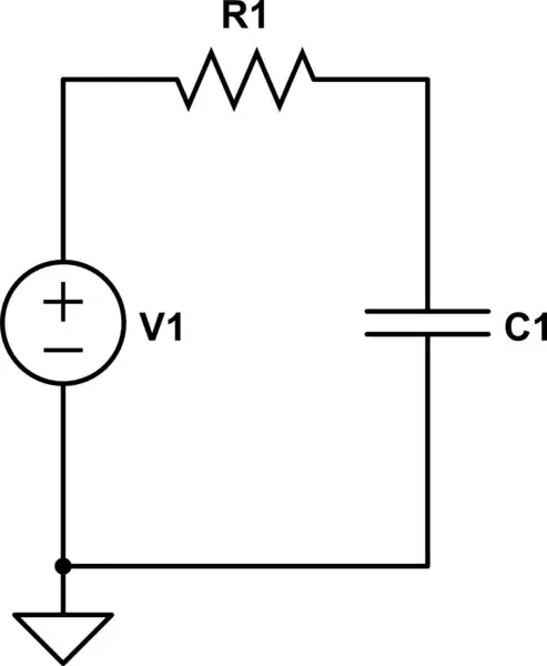

schematic
The capacitor represents the capacitance of the circuit this is driving. But, this should look pretty familiar--it's a basic RC low-pass filter. The speed at which we can charge that capacitor is controlled by the value of the resistor--the larger the resistor, the longer it takes to charge.
This is where power consumption comes into play: to reduce the rise time, we need a smaller resistor. But a smaller resistor also means that when the input to the FET goes high so the output is low, the FET has to conduct more current through to ground.
Thus, we fairly quickly reach a point where a faster circuit consumes a lot more power--and we need to use bigger transistors to handle the amount of current that's flowing when the transistor is conducting. And that means our circuit isn't just more power hungry, but it also consumes more chip area (and remember, due to the resistor, it's already big), so a given amount of logic becomes substantially more expensive.
