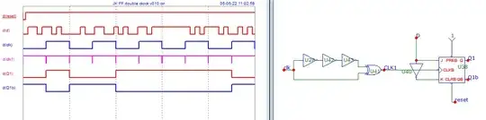

As @TimWescott proposed, first idea ...
Do you need something as this?enter image description here
