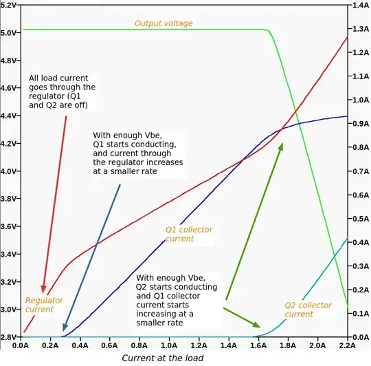

No, they cannot (at least not directly, as detailed in the question). To increase the maximum current an external transistor can be used, as shown in the datasheets of different manufacturers (which recommend the same solution):
ST: enter image description here
TI: enter image description here
Trying to improve, as requested in the comments:
  • Note 1: disregard the actual values as they depend on models and resistor values (the purpose is just to show the operation of Q1 an Q2).
  • Note 2: this is not what will happen in a real circuit as the output current increases with time because the simulation doesn't take the IC thermal protection into account (this is merely an operating point analysis).
To be clear without requiring the reading of all the comments: this is not a recommended solution for many situations. It is very unlikely that this circuit (at least the power transistor) would survive a prolonged short-circuit.

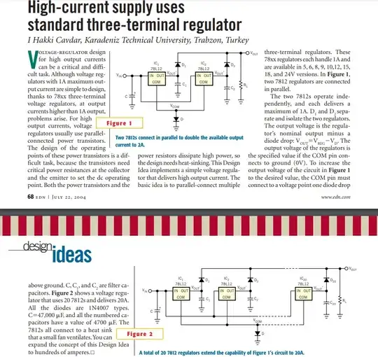

Here's an EDN Design Idea which parallels standard 3-terminal regulators using diodes:
https://www.edn.com/high-current-supply-uses-standard-three-terminal-regulator/
and below is the article from the 2004 Design Ideas archive.
The article claims there is no limit to the number of regulators you can parallel in this way.
