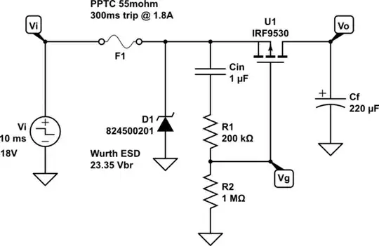

U1 would be replaced based on design parameters but a quick hack uses the default PMOS model for simulation.
schematic

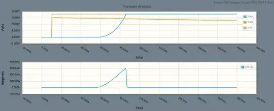

Simulation time-domain

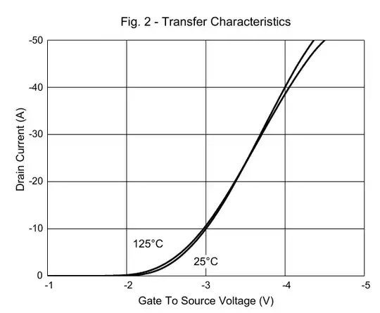

Based on a related question, at these time scales U1 risks entering thermal runaway and there is barely any other resistance in the charging path so it could fry due to the Spirito effect. However, am I right in thinking that if I use something like the MCG35P04 which has only a weak thermal effect against Vgs:
Vgs against Id
then runaway may be mitigated?

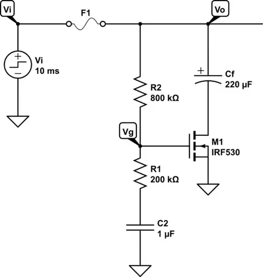

It's possible to replace the PMOS with an NMOS and put it only in the charging path of the capacitor:
schematic
simulate this circuit
