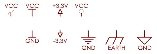

Yet again, we are debating with colleagues to choose the correct power symbols in our schematics.

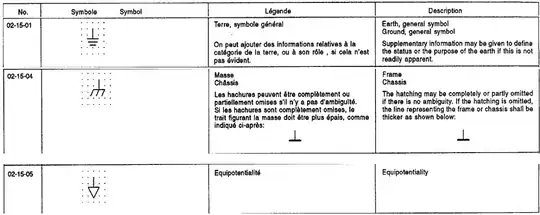

Some argue that using the horizontal 4-lines symbol for GND is a misunderstanding because this is not a real ground. Others say that only arrows are valid. On the 60617-2 snippet below, one can see that in French, the 02-15-01 symbol is named "Terre" (Earth) in french, but "Earth/Ground" in english. Thus, I am used to using this symbol when something is physically connected to the Earth.
So my question would be: is there an ISO/IEC standard about power symbols used in EDA, and which symbol is used to differentiate signal "GND" from power ground connected to Earth?
Here are some examples in my EDA software:
In ISO/IEC 60617-2:1996 I only found these references. It seems that all other symbols are not standard. Is that correct?

  • All of the ground symbols except the -3.3V are at least "de facto" industry standard. I would avoid to assign any special meaning other than general ground to the first ('T' upside-down), third (4 lines) or fifth (triangle). – Lundin Apr 19 '22 at 12:48

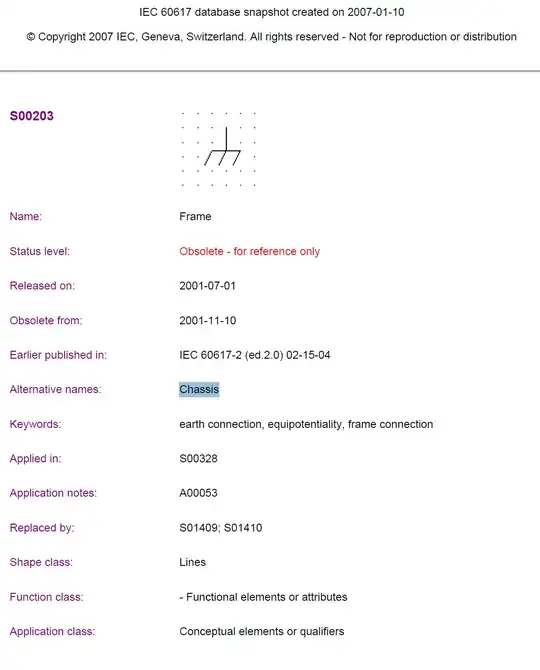

IEC 60617 (2007) The IEC 60617 snapshot taken in 2023
I’d like to add that the IEC 60617Frame/chassis” symbol had once been obsoleted in 2001, and has been revived and renamed to “Functional equipotential bonding.” Now it stands for more general things.

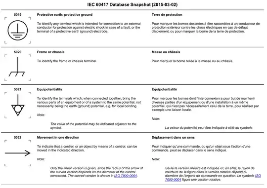

IEC 60417 does not contain schematic diagram symbols.
Note that the icons in IEC 60417 are irrelevant as for schematic drawings.
IEC 60417 (2015)
IEC explains:
IEC 60417 graphical symbols are primarily intended to:
  • identify the equipment or a part of the equipment (e.g. a control or display);
  • indicate a functional state (e.g. on, off, alarm);
  • designate connections (e.g. terminals, filling points for materials);
  • provide information on packaging (e.g. identification of contents, instructions for handling);
  • provide instruction for the operation of the equipment (e.g. limitations of use).
IEC 60417 does not apply to symbol originals for:
  • safety signs;
  • use on drawings and diagrams;
  • use in technical documentation of products and in technical product documentation;
  • use for public information.
