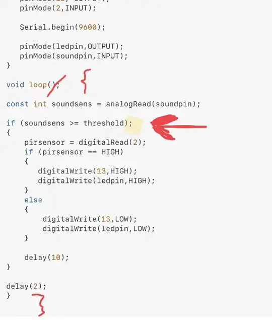

int pirsensor = 0;
const int ledpin=11;
const int soundpin=A2;
const int threshold=200;
void setup()
   pinMode(13, OUTPUT);
   pinMode(2,INPUT);
   Serial.begin(9600);
   pinMode(ledpin,OUTPUT);
   pinMode(soundpin,INPUT);
void loop();
const int soundsens = analogRead(soundpin);
if (soundsens >= threshold);
    pirsensor = digitalRead(2);
    if (pirsensor == HIGH)
       digitalWrite(13,HIGH);
       digitalWrite(ledpin,HIGH);
    else
        digitalWrite(13,LOW);
        digitalWrite(ledpin,LOW);
    delay(10);
delay(2);
The error code is copied below:
testcodefor_soundsensorandPIR:20:5: error: expected unqualified-id before 'if'
     if (soundsens>=threshold,pirsensor = HIGH);
testcodefor_soundsensorandPIR:21:1: error: expected unqualified-id before '{' token { ^ testcodefor_soundsensorandPIR:36:10: error: expected constructor, destructor, or type conversion before '(' token delay(2); ^
testcodefor_soundsensorandPIR:37:1: error: expected declaration before '}' token } ^
> exit status 1 expected unqualified-id before 'if'
note this is my attempt to combine codes I was never taught coding

  • Your loop() function isn't a function. You've declared it but not defined it, because you put a semi-colon on the end, and then you forgot to use an opening brace { to start it. – brhans Apr 08 '22 at 00:33
  • You can't separate 2 expressions in an if statement like that. If you want to evaluate different things you need to use the boolean operators like && and ||, and you can't end an if with a semi-colon. – brhans Apr 08 '22 at 00:36
  • And although the compiler doesn't care about the way you indent or space your code (or not), being consistent about it makes it so much easier to read and debug. – brhans Apr 08 '22 at 00:40
    And lastly (from me anyway) this is a pure C coding question and belongs on stackoverflow. – brhans Apr 08 '22 at 00:44
That if statement does not make sense. Remove ,pirsensor = HIGH and the semicolon at the end.

Delete the semicolon highlighted below in yellow, delete semicolon crossed in red and add semicolons added in red.
