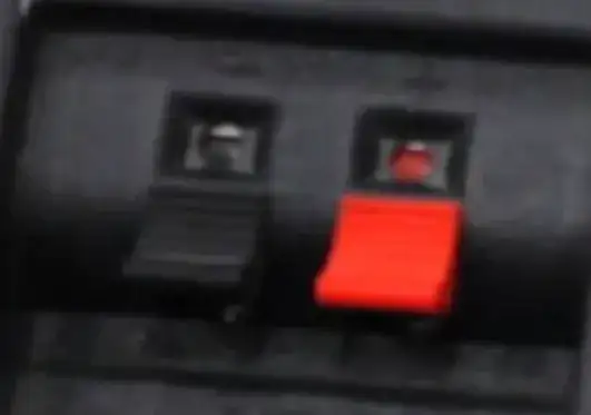

Spring clip speaker terminals are economical and dispense with the need for mating connectors on speaker cables.
All that they require is cable ends stripped of insulation for easy 'clip-on' / 'clip-off'.
They also permit the use of thicker cables.

Cheap speakers generally use this type of connectors, which are ideal in this application.
The user will probably want to hide the cables, or string them behind shelves or thread them through small openings and conduits, and a large connector would prevent that. These binding posts allow use of any lamp cord, and the user can cut it to length, replace it, and change the color of the cable to hide it... It is also thin, so the speaker can be placed against a wall without a connector protruding. Contact is pretty good and reliable because the wire is squeezed between the contacts by a spring. Basically, these are cheap and they do the job very well. For this application, you don't want connectors.
The only big drawback is you really have to remember to turn the amp off when fiddling with the wires, because they will probably short while you do so.

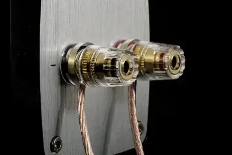

More "high-end" speakers use posts like this:
If you get high-end speakers, you won't put them against the wall, because that makes the bass response ridiculously bad, so protruding connectors are less of a problem. That said, these binding posts are garbage when used with bare wire, because speakers vibrate, so they unscrew over time. The screw part is useless, and they're only reliable when used with banana jacks. So, ironically, the "high-end" gold-plated stuff is worse than the cheapo springy binding posts.

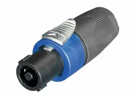

Pro-audio/stage gear always use connectors, because they must be installed quickly and often, and with correct polarity. Sometimes it's a 6.35 mm jack for low power, which is a terrible connector for this, because it shirt-circuits at insertion. Sometimes it's XLR, which is decent. Both jack and XLR are hazardous to the survival of the rest of the equipment, because then you get cables lying around with one end connected to a power amplifier, and the other end offering a connector that will fit just right into a lot of other stuff that should never be connected to the output of a power amplifier. And last, we have Speakon connectors of course, which are just awesome:

XLR/Speakon and other professional connectors: Too expensive, too bulky, risk of confusion with other mechanically compatible connectors on equipment not intended for connections to speakers or amplifiers.
