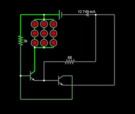

Recently received a small PCB from China with a simple LED driving setup (12v input).
I spent some time probing it out and reverse engineered this schematic;
actual circuit

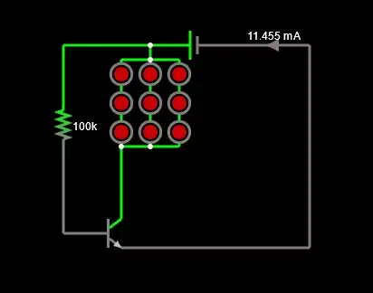

I'm trying to understand why they designed it so that this uses 2 transistors (granted my understanding of transistors is still limited) while this following circuit would do the same thing if the simulation is correct.
hypothetical circuit
I'm sure with it being Chinese there are some omissions (some footprints weren't populated, all were parallel resistors however). But i'm mainly just hoping to learn.
Tried my best to search around for answers but I couldn't find anything on here (probably don't know the proper terms to use).
I've been dabbling in entry level hobby electronics for some time, micro controllers and the like. But when things get specific I often have no idea what I'm looking at.

    Your second design has no current regulation. If the transistor doesn't limit it properly the leds or the transistor will go poof. – Passerby Apr 04 '22 at 03:03
  • Second design actually work. I do have a flashlight (I modded myself) with exactly that circutry albeit different parts. Battery is Li-ion (1 cell 21700, protected of course), resistor 4.7k, LED - 8x5mm while LED's and D882P NPN transistor. LED current is regulated far better than with an resistor only (Battery positive-switch-resistor-LED positive-LED negative-battery negative). Here LED current is roughfly proportional to battery voltage (until battery is nearly depleted at 3.3-3.4V) – Volodymyr Kalinyak Apr 04 '22 at 19:22

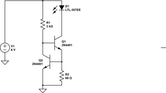

It's a constant-current circuit. The current should be about 0.7/68 ~=10mA.
schematic
Your circuit with one transistor would allow a highly variable current to flow through the LED(s), dependent on the supply voltage and the gain of the transistor which is not well known to begin with and will vary greatly with temperature.
The way it works is that Q2 takes current away from the base of Q1 as the voltage across R2 reaches around 0.7V. The current through R2 is very close to the current through the LED(s), only different by 1% or so if hFE \$\ge\$ 100 for the transistors.

    @MarkRansom OP's actual circuit has 3 LED drops in series (so about 9V) plus the 0.7V across the 68R so only 2.3V across Q1 and thus only 23mW rather than 83mW. With a TO-92 the rise is about 200°C/W so even 83mW isn't too alarming (17°C rise over ambient vs. 5°C). If there was just one LED you'd likely just use a resistor rather than a crude current source. – Spehro Pefhany Apr 03 '22 at 23:26

The circuit with two transistors, even if drawn in a non-obvious way, is a constant current circuit for driving the LED.
When enough current flows via 68R resistor, the voltage over it rises, which in turn starts turning on the second transistor, which starts to take away base current from the first transistor.
So the circuit with two transistors provides feedback for constant current driving.
The circuit with only one transistor is much worse, because it relies on the current gain of the only transistor, and the manufacturing tolerance for current gain is huge, so the collector current might be 100x or 400x times the base current, which obviously would be a bad constant current driver.
