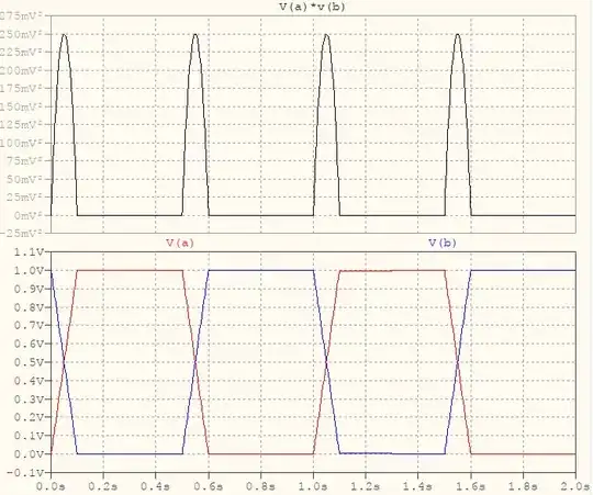

My thoughts are in line with @Bart's comment, so I'll post what (hopefully) should be the thousand words:
nothing is perfect
Consider V(a) and V(b) two waveforms that switch between 0 and 1. Since nothing happens instantaneously in nature, the transitions between the values takes a finite time. If one of them is a voltage and the other is the current, then the two, multiplied, will give the power. But when V(a)=1, V(b)=0, and vice versa, so when the multiplication happens during their maximum/minimum values, the power is zero. Therefore the only times when the power takes value is during transitions and, because the two quantities are ideal and linear, it takes the form x(1-x).
In rest, all the other answers have already explained at large with examples, and mentioned that nothing happens for free (you need work to make the switchings happen).

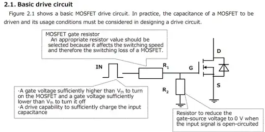

--- UPDATE --- It seems that nobody thinks that a resistor in series to the gate is often necessary, surely when the driven mosfet is a power mosfet, like those used in H-bridges. The third result from a search on the internet leaded to this document by Toshiba which, at point 2.1 "Basic drive circuit" shows the gate resistor with the associated explanation:
basic gate driver

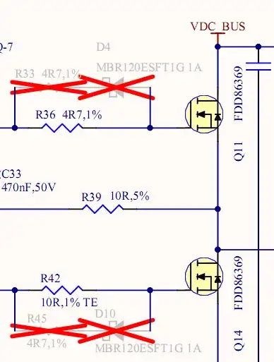

Another example, taken from a real board (a brushless controller), which also shows the value of the resistor (the driver is a FAN7382:
Now, I agree that often there is no gate resistor. This is a particular case where the gate resistor is near to zero, but anyway the stored charge in the gate must be dissipated when driving the mosfet off. If the driver of the gate can withstand the peak current and/or the total power, taking also in account the frequency of the switching, then no resistor is needed.
