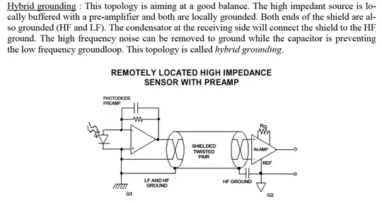

I have some basic questions regarding the circuit shown below:
circuit
The image is from this question.
The buffer is sending signals through a twisted pair cable to an in-amp. My questions are:
  1. Does the buffer have other functions than to increase the signal strength? Maybe a transformation from high impedance to low impedance?
  2. If so, is the low impedance after the buffer important to avoid noise through external magnetic fields? Would it be wrong to have a long distance between the sensor and the buffer, because the impedance between senor and buffer is high?
  3. I have read impedance matching is important. But the output of the buffer is low and the input of the in-amp is high. Is it ok?

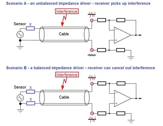

Impedance matching can mean several things. In this scenario, you might need cable termination impedance matching (for high speed signals) but, you will also need balanced driver matching at the transmitter (as described above) and a balanced impedance at the receiver.

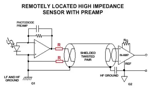

Regards the transmit end, it might be a good idea to put series resistors in the feed leads like this: -
The reason should now be clear; the output from the driver may be a few ohms whereas the other wire in the twisted pair is "hard" connected local ground. This is not ideal and the two resistors shown as "R" will "balance" driving impedances and reduce the impact of noise due to equalization.
Balancing the driver and receiver is all about making sure that whatever noise influences the wires in the twisted pair, it influences both wires identically. The InAmp will do the rest.
    The buffer doesn't merely increase the signal strength. It entirely converts the type of the signal: from a current signal to a voltage signal. It also biases the photodiode with a constant voltage, decreasing its effective capacitance and thus speeding up the sensor. The photodiode is effectively shorted, with a zero voltage across it. So, the input voltage to the buffer is almost exactly zero, but the current varies. The output voltage of the buffer varies a lot, and the current varies proportionally due to capacitive loading or line termination.
  2. Would it be wrong to have a long distance between the sensor and the buffer?
    Yes, because the signal from the photodiode to the buffer is low-level and thus much more sensitive to interference.
    The buffer amplifier essentially shorts the diode: it acts as an ideal current measurement shunt. Thus diode-to-buffer circuit is very low impedance. It is not sensitive to external electric fields, but is very sensitive to external magnetic fields. The lower the impedance of a circuit, the more sensitive it is to magnetic fields. An ideal magnetic field sensor is a superconducting short circuit loop of infinite area :) This sensitivity is proportional to the area of the loop formed by the photodiode circuit, and inversely proportional to the resistance. If the photodiode were to be far from the buffer, a nearby source of magnetic fields, such as a mains transformer or a parallel cable carrying AC currents, would easily induce interfering signal into the diode circuit.
    On the other hand, high impedance circuits are sensitive to external electrical fields, but not much sensitive to magnetic fields. As the impedance of the circuit rises from a short to an open, the sensitivity shifts from magnetic to electric fields.
    It is OK as long as the highest frequency seen in the signal output in the buffer has a wavelength much longer than the length of the cable. If the wavelength of highest frequency signal is shorter than 5-10x the cable length, then the cable must be terminated on both ends. It then needs a series resistor between the buffer output and the cable, and a parallel resistor across the in-amp input. The resistance should be the same as the characteristic impedance of the cable used.
