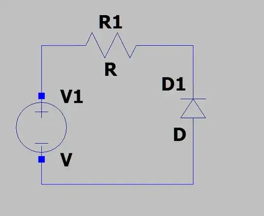

Lets say we have a circuit as shown in the image diode circuit
Given that we know the impedance of the resistor as well as the PD of the voltage source, how can we predict the voltage drop across the diode? The characteristic V-I plot of any standard diode shows that for different voltages across the diode the current passing through it is different. So it is enough for us to obtain the voltage drop across the diode to find out the current flowing through it. However in order to obtain the voltage drop(without actually measuring with a voltmeter and only using analytical methods) we need to know the impedance of the diode which in turn depends on the voltage drop across the diode(non-linear nature of diode V-I). I would like to know how this problem is resolved.

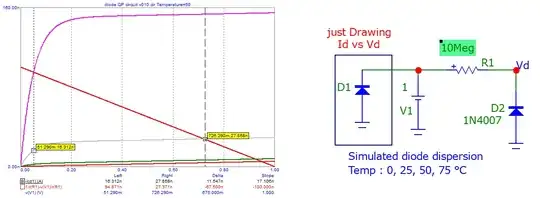

    If the diode is well polarized, just draw the "load line" and "solve" graphically. Take into account the temperature ... – Antonio51 Mar 20 '22 at 17:53
The "load line" is drawn as usual by passing between 2 points.
The first point is obtained by \$(Vmax, I=0)\$ and the second point by \$(V=0, I=Imax=Vmax/R1)\$, hence the equation of this line in the diagram \$(I, V)\$, i.e. \$I(V1) = Vmax/r(R1)-v(V1)/r(R1)\$.
r(R1) and v(V1) is the syntax for the simulator as they are "variables".
Take into account the temperature ... Diodes under test are 1N4007.
If diode is reversed, then this is the figure ...
Antonio51
  • 13,128
  • 22
  • Your circuit is much different from the circuit in question, so that your results are not applicable. – Elliot Alderson Mar 21 '22 at 00:08
  • This circuit is only to show HOW it can be solved. The original circuit is just a "reversing" of the diode. Current would only be more "little". – Antonio51 Mar 21 '22 at 07:49
  • I would like to know how this problem is resolved. NB: The voltage of the OP question was not "precised" (positive or negative).
    – Antonio51 Mar 21 '22 at 08:09
  • Perhaps you should add some text explaining your answer. How is the OP supposed to infer your meaning from a screenshot or a wall of equations? – Elliot Alderson Mar 21 '22 at 10:39
