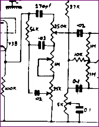

Here are a couple of example clips from old schematics:
One where they should have used the notation discussed (60's guitar amp schematic - is that .02uF or 2F? ;-) ):
Example 1

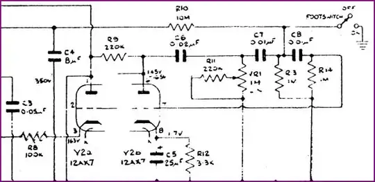

Another bad one:
Example 1A

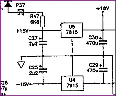

Two clips from a better schematic from the mid 70's with the same convention used for capacitance also, plus nanofarads are used (in earlier schematics 22nF would be presented as 0.022uF):
Example 2
Example 3
Schematics found at Dr.Tube and Vox Amps. It's interesting to browse through the schematics and note the differences in notation over time.
