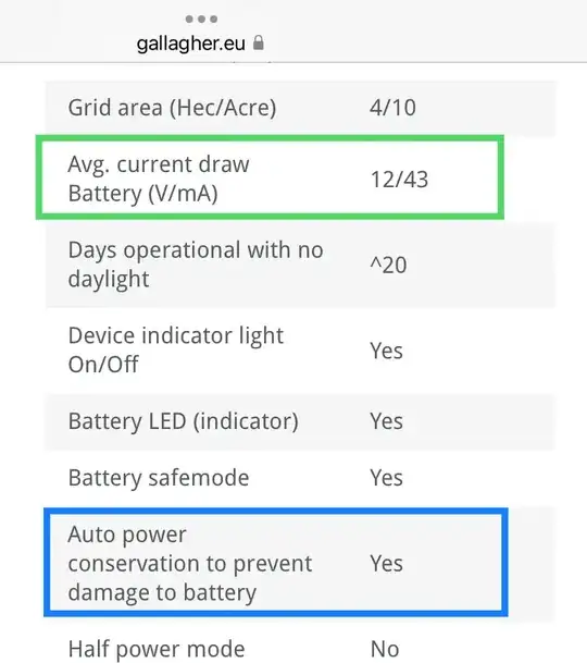

According to Gallagher manufacturer datasheet, using original 7.2Ah:
So the charger can recharge the battery - same 12V rating - with a bigger capacity, being protected from an undervoltage event that could damage any SLA battery life.
An important point here is that 43mA x1h = 43 mAh or x 24h = 1A.Day
From 7.2Ah to 10Ah, the new battery will last longer, even if sun is not available. Proportions assumed and probably enabling some energy saving features as night-mode, etc., it may last about 30 days.
