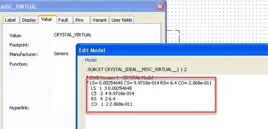

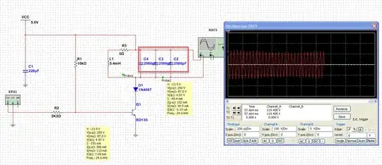

I'd like to model this passive piezo transducer "reasonably" in Multisim, which means not just modeling a capacitor or a generic crystal or a generic RC circuit. The 'why' revolves around resonance, voltage spikes, current draw, undampened oscillation, and the like. For example, the 100V+ peaks should not happen if I can model the piezo transducers properly (please ignore this throwaway schematic otherwise).
failed sim

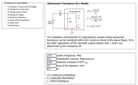

REF: https://www.biosono.com/PrmtLgd/PrmtLgd.php?id=TrnsRlc
