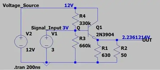

I would like to understand/create a circuit which amplifies an input signal with a base-emitter follower. Sadly, I’m not getting any amplified signal at the output. I don’t really understand why on point Q only 3V are present, considering the voltage divider should increase the bias voltage of the transistor to around 11V. Can someone please help me understand why I’m getting a lower output voltage than the input voltage (shouldn’t it be amplified)?
Circuit: enter image description here
Thank you

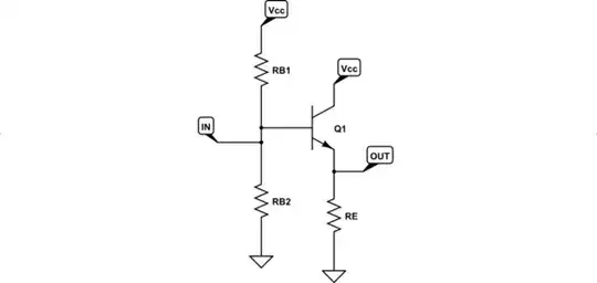

You have lots of problems in your understanding with this circuit. (The base pair is terribly sized, for example.) But let's take it slowly.
schematic
In your circuit, though, you directly drive the base of \$Q_1\$ with a voltage source. So the base resistors are irrelevant. The still more simplified circuit becomes:

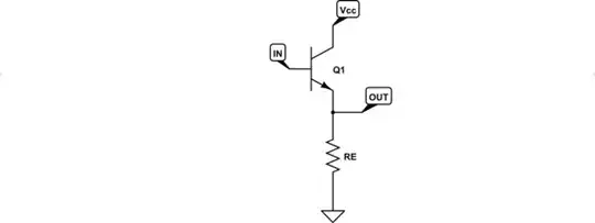

From this, you should be able to easily see that the emitter will be about a diode drop below the base voltage -- no matter what the base voltage is. So the emitter will just be about \$700\:\text{mV}\$ below the base. It will "follow" the base, so to speak.
The only new aspect here -- the only contribution that the BJT adds to this -- is that its collector can supply lots of current directed towards the emitter to "help" the base. So if the input source is at \$V_{_\text{IN}}=2\:\text{V}\$, for example, then the emitter will be at about \$V_{_\text{OUT}}\approx 1.3\:\text{V}\$ and only a tiny current will be drawn from the base with the most of the rest coming from the collector - which is directly tied to \$V_{_\text{CC}}\$ so it can provide a lot of current that way.
So this is a current-amplifier, in the sense that a tiny base current is supplemented by lots of collector current to create the emitter sourcing current into whatever else is connected to \$V_{_\text{OUT}}\$.
That's useful if \$V_{_\text{IN}}\$ can't source a lot of current and if \$V_{_\text{OUT}}\$ needs to source a lot more to whatever is connected there.
However, there is no voltage gain here. Quite to the contrary, in fact. There will be a small loss. Perhaps 95% or 98% of the original signal is all you can expect? But nothing greater than 100%.

The base-emitter junction is a diode, and the forward voltage of a silicon diode is approximately 0.7 volts, so the emitter voltage in an emitter follower will be about 0.7 volts below the base voltage. The voltage gain of an emitter follower is 1.
As Point Q is directly connected to the output of your V1 signal source, its voltage will be the same as the signal source. If you place a capacitor between V1+ and Q, the voltage at Q will be set by the voltage divider consisting of R3 and R4. The voltage divider will set the base voltage to about 8 volts if V1 is removed.
