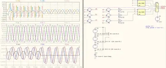

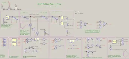

A proof of concept can be simulated in SPICE. While I could show an exploded view with all the gory details, I'd say a schematic at block level can be read much better.
There are a few shortcuts I used, mostly for the sake of space, to be able to show al the schematic at once. The voltages are directly measured against a some common point, nul, but here they represent (1a,b,c), which still stand:
(1a, 1b, 1c)
[EDIT] Note that the upper graph shows a grey label but an orange trace. That's the result of a .STEP, which has one of the traces (grey) as being null, and the other (orange), non-null. If you zoom in you'll see that the X axis is a slightly lighter shade of grey than the Y axis, when they should be the same -- that's the zero valued first trace. The exaplanation is at the end edit. [/EDIT]

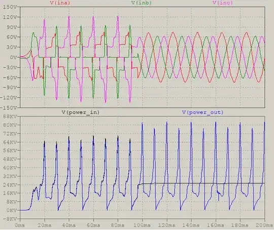

Then, I used some emulated NTC, which is also deleted from the final schematic, but the currents will show a gradual rise. Lastly, the formulas above are for a constant power strategy, but I'm showing a sinusoidal current strategy, that's why you'll see a Clarke transform for the currents which is not used and, instead, some unity sine/cosine are used; the purpose was a better viewing of the graphs.
APF, sinusoidal current strategy

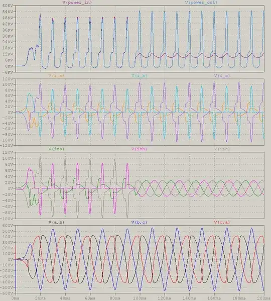

Ug is the grid (up, left), feeding two nonlinear loads: two bridges, one with a parallel RC (usual rectifier, 3 phase), and one with a series RL (but only on two phases). In the lower side there are the isolated voltage sensors [consider them (1a,b,c)], the Clarke matrices for both currents and voltages (2), calculation of powers (3) [with the modification mentioned above], selection of powers (ignore the i_zero, it's null), calculations of compensating currents in the \$\alpha\beta\$ domain (5), inverse Clarke (6), feeding the compensating currents back into the grid through the Ga, Gb, Gc current sources.
APF waveforms
[EDIT 2] I forgot to post this last time, but the loads have changed to the regular bridge + R||C that you see, plus a simple series RL connected between phases a and b. Ultimately, it doesn't matter, the purpose was to have a nonlinear load and an imbalanced load, and to see how the PW theory works. [/EDIT 2]
Plotted are (top to bottom): powers calculated before and after the point of common coupling (PCC nodes), the output currents, the input currents, and the LL voltages showing unbalance (V(a) is 0.8 pu) and harmonics. At 96 ms the APF turns on, showing clean sinusoidal currents on the input side. If the power strategy would have been used, the currents would have still had harmonics (though greatly reduced), while the input power would have been flat:
power strategy

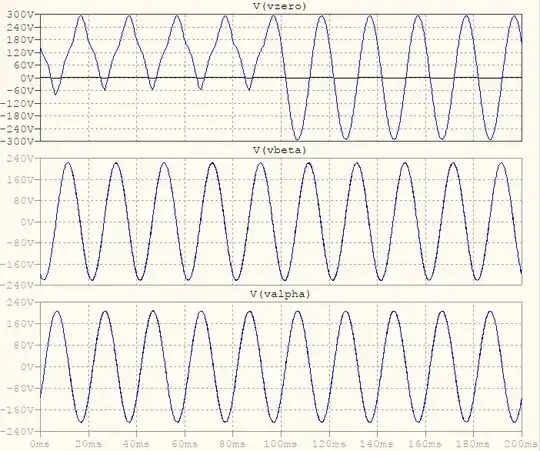

$$\begin{align} \sin(x+\theta)&=\cos(\theta)\sin(x)+\sin(\theta)\cos(x) \tag{7a} \\ \sin(x-\theta)&=\cos(\theta)\sin(x)-\sin(\theta)\cos(x) \tag{7b} \\ (7a)+(7b)&=2\cos(\theta)\sin(x) \tag{7c} \\ v_{ab}&=v_a-v_b \\ v_{ab}-v_{ca}&=v_a-v_b-(v_c-v_a) \\ {}&=v_a-v_b-v_c+v_a \\ {}&=2v_a-v_b-v_c \tag{8} \\ v_a&=\sin(x),\;v_b=\sin(x-\dfrac23\pi),\;v_c=\sin(x+\dfrac23\pi) \\ (8)&=2\sin(x)-2\cos(\theta)\sin(x)\Biggr|_{\theta=\frac23\pi} \\ {}&=2\sin(x)-2\cdot\left(-\dfrac12\right)\sin(x) \\ {}&=3\sin(x) \tag{9} \end{align}$$
These relations hold only as long as there is no imbalance. But -- and here is the key -- the Clarke transform cancels the zero component, which is not needed in a 3-wire system. This is why you can see a non-zero trace in the upper plot of the 1st picture (orange), versus a zero valued one for the other (grey, overlayed on the X axis).

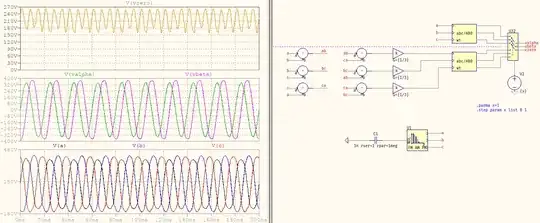

To further prove this, in the previous pictures the generator is disposed in Y, even if the common (the NUL pin) is clearly connected to a capacitor in parallel with a 1 MΩ resistor (and a series 1 Ω to limit the potential currents) -- it is floating. So, this time, here is a Δ generator, and how the waveforms look like before and after the Clarke matrix, for each (note the imbalance in V4):
Delta generator
The bottom plot shows the LN voltages, referenced to the SPICE ground (ugly, meaning the voltage across C7 will not be zero), the middle shows the derived voltages, and at the top there are the resulting currents for a constant power strategy -- showing that the scheme works. I've left the αβ components separate, for better viewing:
Clarke for Delta generator
Here, too, the zero component is non-null, but this time it's on the abc side, since they are derived from Δ, not Y.
So, as a conclusion, it doesn't matter how the derived abc come out, the Clarke matrix and the subsequent power calculations will correctly account for the 3- or 4-wire system, since the purpose of the Clarke matrix is to consider the three-phase as a whole, not as individual, summed components.

  • If equations 1 are true, that seems to be all you need to weed out the neutral referenced voltages from line-to-line measurements for an arbitrary 3-phase load or source so should work for a neutral-less wye. Not obvious to me why it would be true glancing at a wye though. – DKNguyen Feb 24 '22 at 18:52
  • @DKNguyen I see now that I forgot to mention something, even if it is in the 1st picture. The zero components are different (top plot): for the regular abc voltages, the zero component is non-null (orange), while for the derived method, it is (I stepped a value and you can see that the label is grey, while the plot is only orange, and the 1st stepped waveform, because it's zero, it's mistaken with the X axis). It makes sense, since it's a 3 wire system, but it's not clear from the plot. But if they are different it's only because of the imbalance. – a concerned citizen Feb 24 '22 at 19:05
  • Also, the equations make sense if you consider that Vab=Va-Vb, so Vab-Vca=Va-Vb-(Vc-Va)=Va-Vb-Vc+Va=sin(x)-sin(x+2/3*pi)-sin(x-2/3*pi)+sin(x)=2*sin(x). Hm, now I see I also forgot the scaling, but you can see it in the 1st picture. – a concerned citizen Feb 24 '22 at 19:11
  • Equations (1) aren't checking for balanced or unbalanced out unless Va, Vb, and Vc are not supposed to be neutral referenced voltages but something else. Falstad Simulator: https://tinyurl.com/y7hb4u2f – DKNguyen Feb 24 '22 at 22:54
  • @DKNguyen They do, see my 2nd comment: after the Clarke matrix the zero component is non-null for derived equations when there is imbalance, but it can be discarded. You can clearly see that the results are the same. The change was made for the constant power strategy (hence the slightly distorted current), but the currents overlap. Also, what you're showing seems to be just a summing of the three voltages, not a Clarke matrix. – a concerned citizen Feb 25 '22 at 09:47
