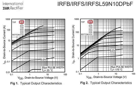

    Fig. 2 in your datasheet shows that Rds saturates to a constant value above 10v, so going higher will not help. – user1850479 Feb 14 '22 at 15:22

  • Why bother specifying at 20 volts or 30 volts when the data sheet graphs can tell you what the likely improvement in \$R_{DS(ON)}\$ is at higher drive levels like 15 volts. Admittedly it's not 30 volts, but, the gains to be made are meagre or small: -
  • You can estimate \$R_{DS(ON)}\$ (at higher G-S voltages) to a reasonable degree of accuracy using the graphs in the data sheet

Look at the graphs above - I'd say there was a significant diminishing return. Remember also that this device is targeted at high frequency applications so it's a compromise on how strongly you drive the MOSFET (conduction losses) versus how quickly you can drive it from one state to the other (switching losses): -

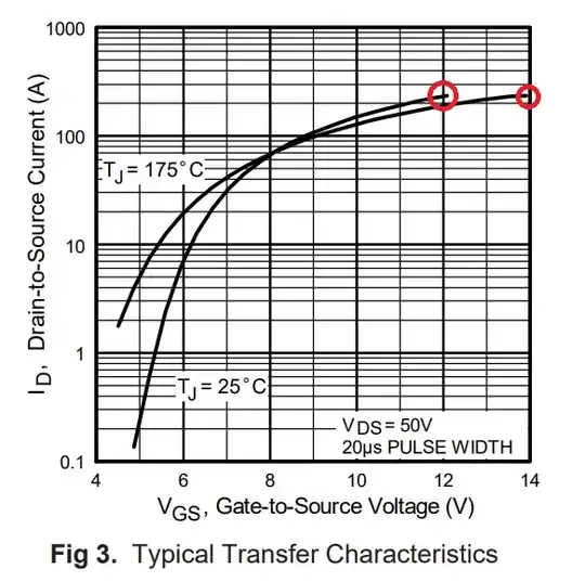

I would have to have good reasons to want to exceed this graph in the data sheet: -
I might initially consider a 15 volts G-S drive level but, I'd also be mindful that if the MOSFET junction temperature rose towards 175°C, it could take an excessive drain current in some circumstances. So, I'd probably end up restricting my drive level to 12 volts in the end.

    Something seems to have gotten a bit confused at the end of this answer. Your last point about not wanting to drive Vgs above 12V based on the "Fig 3. Typical Transfer Characteristics" seems to imply you're misinterpreting that graph (or assuming an ideal voltage source for Vds). That graph doesn't indicate that a higher Vgs will result in a higher Tj. It says that with a higher Vgs the part can sustain a higher Id (if that's what is possible from other parts of the system) and still maintain the same Tj (i.e. the curves are points where the same power will be dissipated in the junction). – Makyen Feb 15 '22 at 03:03
  • While there are other considerations as to why one might want to limit Vgs to a lower value, the issue usually isn't Tj. It would be Tj, if what was supplying Vds was quite close to an ideal voltage source (i.e. nothing in the system limits the possible Id, which may or may not be the case). If Vds is truly fixed and there's nothing limiting Id, then, yes, you want to limit Vgs, as having an Rdson which is too low would result in too much current, and thus too much power being dissipated in the device. However, there's usually something else limiting Id, particularly if switching. – Makyen Feb 15 '22 at 03:03
  • @Makyen Yes it reads a little confusing. I didn't mean that driving the gate harder causes an excess of temperature directly but rather that I should be mindful about the junction temperature being high. – Andy aka Feb 15 '22 at 09:01
