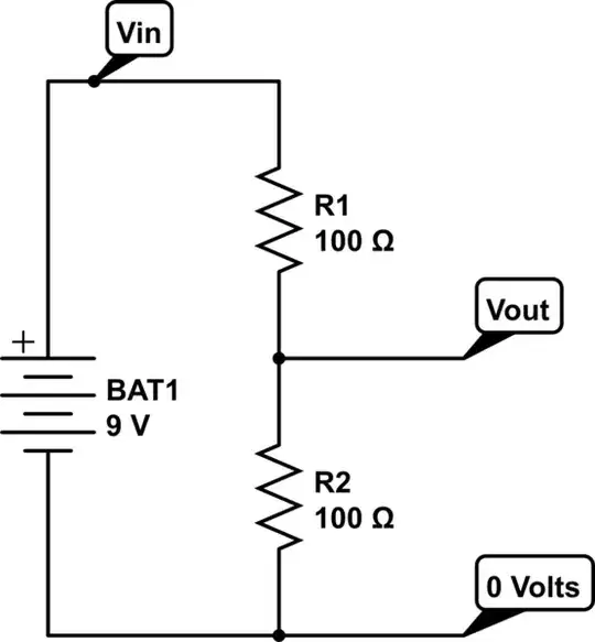

Ground is just a point in the circuit that we choose to call "Zero Volts". It has no magical properties.
Your circuit could be re-drawn as:

10
In your example, we assume no current flows to \$Vout\$, it's only a measurement point. Pretend it's literally just a point floating in space with no connection except to the junction of \$R1\$ and \$R2\$.
Also, the current flows in a loop, by convention (more below) from \$Vin\$, through the two resistors, through ground, then back to whatever is creating \$Vin\$ (a battery, say.) Ground is just a reference to zero volts.
With that out of the way, we know that each resistor has its own voltage drop. The sum of these voltage drops will be \$Vin - GND\$, or just \$Vin\$.
You can also see intuitively that \$Vout\$ will depend on the ratio of the two resistors. If \$R1\$ is equal to \$R2\$, then the proportion of the voltage drop is equal, so \$Vout = Vin/2\$. As \$R2\$ decreases its voltage drop also decreases, while \$R1\$ voltage drop increases.
How do we analyze it? Ohm’s Law, and a couple of other laws.
In a series circuit like this one the current in any part of the circuit is the same. That's Kirchhoff's Current Law, or KCL, as applied for simple current loops.
Kirchhoff's Voltage Law, or KVL, states that all the voltage drops in the circuit must add up to the total voltage. Based on KVL, we know that the sum of the voltage drops of all the elements equals \$Vin\$.
With these tools in hand, let’s get cracking.
We begin by finding the series circuit current using Ohm's Law as:
  • \$ I = \frac E R\$
with total resistance \$R\$ being the sum of \$R1\$ and \$R2\$. We plug those in and solve for \$I\$:
  • \$ I = (Vin - 0V) * \frac {1} {R1 + R2} = {Vin} * \frac {1} {R1 + R2}\$
Based on KCL, we know that the current through each resistor is the same:
  • \$ I = I_{R1} = I_{R2}\$
So we can solve for \$Vout\$ with Ohm's Law again:
  • \$ E = I*R\$
We use KCL to substitute the total current \$I\$ for \$I_{R2}\$, and finally calculate \$Vout\$:
  • \$ Vout = {I} * {R2} = [Vin * \frac {1} {R1+R2}] * R2\$
or,
  • \$ Vout = Vin * \frac {R2} {R1+R2}\$
which you may recognize as the voltage divider equation.

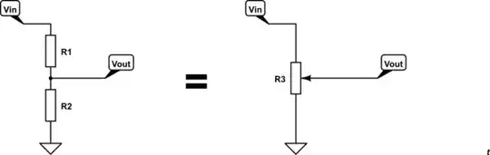

schematic
Figure 1. A potentiometer (right) is a variable version of the potential divider (left).
Consider the potentiometer (a volume control for example). By adjusting the wiper from bottom to top any fraction of Vin can be selected. It should be clear that at the bottom Vout will be 0 V and at the top it will be Vin. 40% of the way up Vout = 0.4 Vin.
  • If we omit R2 we will have R1 in series with the supply voltage.
  • If we short circuit R2 then Vout will always be 0 V.
Tip: forget about electrons for dealing with practical circuits. Just think of current flowing from + to -. It's the way we all work.
