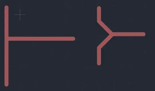

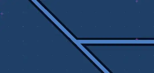

I am routing a SPI line to multiple follower devices.
Currently I have a split in the trace like this:
but it seems like this might not work well.
Are there any best practices for routing to multiple SPI devices in parallel?
\$f\$ = 1MHz
Rise time = 8ns

I am wondering if there are any best practices for routing to multiple SPI devices in parallel.
It really depends on the speeds you want to achieve with that SPI bus, anything under 10MHz and you are unlikely to have problems. After ~30MHz capacitance will start to eat into your risetimes, so any way to keep the capacitance low will be your friend.

If you have a high frequency SPI clock (>Mhz) with high rise and fall times, you should keep the tracks about the same length and continuous, no "forking" and impedance against ground fairly constant (continous ground underneath and same distance to copper in same layer).
The fork design in your picture induces an "acid trap" in the sharp inner corner, which might cause excessive removal of copper. Not a problem in practice with tracks wider than ~0.15 mm, which is an usual standard design rule for many low cost fabs.
In practice it's unlikely you will experience any difference. It will make more sense to not waste design effort and PCB space to optimise the SPI bus for no reason.

  • It seems like forking would be best, since that keeps the length between all the devices more equal? (not that it likely makes any difference in reality). – BeB00 Feb 09 '22 at 19:00
    In practice it's better to take the shortest route to devices and ignore length differences, because then you don't waste PCB space. Only with high frequencies you need to concider shapes of the tracks or forking etc. SPI can be used for high throughput, so there are cases where it does matter. – Ralph Feb 09 '22 at 19:06
  • @BeB00 This is a relatively low speed application (f=1MHz, min rise time=8ns), so I am not too worried about distance differences. – brunerm99 Feb 09 '22 at 19:14
  • @Ralph The traces are 10mil (0.25mm). Thanks for the reply, I had never heard of an "acid trap", but glad to hear it shouldn't be an issue. – brunerm99 Feb 09 '22 at 19:16
I assume your image is referring to MISO/MOSI lines, because the CS line must be individual for each component without any branching.
Anyway, you can absolutely route traces like you did in the image and it will work just fine. The only complaint one might have is that it doesn't look good because you have a less than 90° angle between two adiacent traces, that's why people often use right angle intersections or multiple 45° intersections: enter image description here
Regarding the distance between the traces instead, usually you don't want to route parallel traces too close to themselves to avoid crosstalk, so you either space them a bit or put a ground trace between them, this won't probably be a problem with SPI lines though given that it's not an high speed protocol like HDMI or USB 3.0.
StefanoN
  • 480
    Sharp inner corners are not adviced for manufacturability though. And USB and HDMI data pairs are instructed to be routed close to each other with a specified impedance. So those advice are not correct. I do agree with style guide, I do that too and if I see a sharp corner I've been autorouting or made some other mistake :) – Ralph Feb 09 '22 at 19:12
    @Ralph -- acid traps are generally not a problem with today's manufacturing techniques, other than maybe for home-etched boards. – Scott Seidman Feb 09 '22 at 20:10
