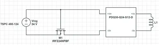

I'd like to protect my board mounted switching regulator's input from reverse polarity events without having to modify the existing run of boards we had created and populated. The primary regulator powers several of these boards that connect via pigtails down the line of cable coming off its 24V DC output.
The vast majority of examples I see online use PFETs for a high-side switch configuration, although it is sometimes noted a low-side nFET configuration works as well. I opted for the latter nFET setup just for better part availability during this supply chain madness and also to have a wider array of options for FETs with a high Vgs. The board mounted switching regulator's input allows a range of 9-36 VDC, which is one of the reasons we chose it. The max input it will ever see is right around 30V, which is the maximum output adjustability that the fine adjust potentiometer on the primary (Vreg) allows. With the load regulation specs, it could technically jump +/- 1%, so I will likely need to ensure it is dialed down to roughly 28-29V. As all of this suggests, I am trying to keep the component count to 1 nFET (with minimum Vgs = +/-30V) because I would like to install this modification as an inline solution in series with the board's input wiring.
A couple questions about this design:
1.) I chose the nFET for parts options, but also because of low Rds (anecdotally). This is also an isolated circuit and the DC negative output from our primary regulator (Vreg) does not bond to any chassis ground or common node. Is it of any concern to proceed with this design? I only ask because of the pFET's popularity in reference material, but understand why people do it.
2.) Should I anticipate any issues with the load it's powering? It's not a purely resistive load, and the regulator it's powering also powers inductive loads itself (12V solenoid valves) as depicted. I am used to installing snubber diodes for the solenoids depicted, but I am uneducated as to the risks, perhaps at a smaller scale, of what the dangers would be after disconnecting the board mounted regulator at Vin. Where does the small amount of EMF bleed in this case? Wouldn't this cause a small reverse buildup (as -Vgs) of a few volts or so? Should I be placing an additional snubber in parallel with the nFET?
3.) Assuming this hasn't been a poor approach, what form factor product can I search for that provides an easier, more modular solution for placing FETs inline on the wire, similar to a fuse assembly?
Thanks for any suggestions.

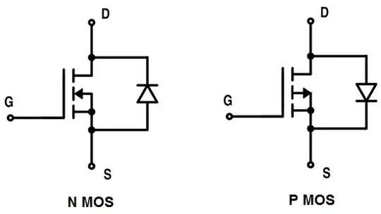

Every discrete MOSFET has an internal body-diode in parallel with the drain to source of the device. Its polarity is such that it is reverse biased in the normal usage. Many schematic symbols do show the diode but the one available here does not.
https://www.quora.com/Why-diode-is-connected-across-the-MOSFET
(Image from www.quora.com)
When using a MOSFET for reverse polarity protection as you show the diode will conduct when the power supply is reverse, this will defeat the operation of the circuit.
Luckily MOSFETs work perfectly well in the reverse direction so swapping the drain and source will achieve your objective.

  • MOSFET as diode. Why just do not use diode? – user263983 Feb 02 '22 at 20:40
    @user263983 - much less voltage drop and power loss – Kevin White Feb 02 '22 at 20:46
  • @user263983 While I can afford the voltage drop of a diode, my device's current consumption during load conditions -- upwards of 1A @ 24V -- made it seem like the heat losses (read: losses into a small, enclosed space that is often placed outdoors in heat) could be better reduced via the FET. – Big Owls Feb 02 '22 at 20:47
  • According to datasheet of some MOSFETs voltage drop is same as usual silicone diode. Why not use Schottky diode if voltage drop critical? – user263983 Feb 02 '22 at 20:50
  • @KevinWhite I did want to touch on that in my original post but forgot to add that. This was my original intention but I goofed and got them flipped during the install, so I decided to publish the schematic of the applied version for conversation's sake. Are you saying you would expect the second regulator (onboard switching regulator) to energize? When I swap the leads to reverse polarity, it does not power on and seems to work correctly. Is this perhaps due to a limited amount of current flow in the wrong direction? – Big Owls Feb 02 '22 at 20:53
  • @bigowls to reduce heat dissipation during regular working cycle meltable fuse in series and diode in reverse parallel to input. The answer recommend to use MOSFET as diode. It will not be open at any polarity. – user263983 Feb 02 '22 at 20:55
  • @user263983 As far as my understanding goes, schottky diode loss: P=0.55V1A = 0.55W. The FET loss: P=11*0.07= 0.07W. I am unsure if this is different for high frequency pulses to the gate vs constant ON. – Big Owls Feb 02 '22 at 21:10
  • @user263983 I'm not sure I understand your comment above starting with "To reduce...". The ground path is open during testing (to what degree I am not certain) – Big Owls Feb 02 '22 at 21:13
  • The internal diode is not added, it's an integral part of the channel N-P junction. The symbol arrow going to the middle is the representation of the body diode. – Louis Feb 02 '22 at 21:22
  • @bigowls The way you draw, MOSFET is always open and does not protect the circuit. The way the answered suggest MOSFET is always closed and resistance of opened transistor irrelevant. It used as diode for reverse polarity protection due to MOSFET nature. – user263983 Feb 02 '22 at 22:04
  • @BigOwls - I'm not sure what you are saying. As you have it drawn the switching regulator will get power even with reverse polarity. If you put the source pin feeding the load with the drain to the 24v input you will get the protection you want. – Kevin White Feb 02 '22 at 22:16

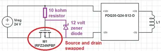

You need to do two things: -
  • In red is the corrected MOSFET position
  • In purple is protection to your gate voltage due to excessive supply voltages
Rely on the diode clampers directly on the solenoids - don't try and protect the MOSFET at a distance - protecting at the source of the problem is all you need to do.
It depends in the main on the current consumption of the regulator and load. Pick a MOSFET that can handle at least twice the incoming supply voltage.
Make sure that the regulator turns off on "under-voltage" before the MOSFET gets used in its linear region because it might fail. This requires careful examination of the data sheet for the regulator to ascertain what under-voltage protection it has.
I'd put an extra bleed resistor of about 10k to 100k on the terminals that connect to "Vreg 24 V" (a confusing label) on the left of the diagram.
