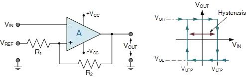

Then you need to use a comparator with hysteresis like this: -
Image from here.
The comparator circuit will enable the device that connects your supercap to the MPPT circuit (maybe you are using a p channel MOSFET?).
To design it correctly you may have to find a comparator (an op-amp will do usually) that can work with the maximum voltage on the supercap. The Vin input will need to be potted down to maybe about 50% of the true supercap voltage and the two resistors chosen so that you have a rising threshold at say 6 volts (10 volts on the supercap) and a falling threshold at about 3 volts (5 volts on the supercap).

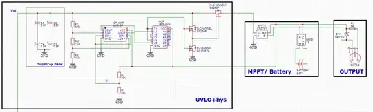

A follow up for my question. Thanks to @Andyaka, I've able to make a design that works. Below is the circuit diagram that I've used. However I haven't tried it on actual yet. Only on simulation.
I'm not sure on the resistor values, although I've tested those on simulation and works well for 10 V to 5 V close circuit, and 5 V to 10 V open circuit.
Note: The super cap is rated for 5.5V, and had been setup in series to cater 10V.
There are also IC that does this function but is not readily available from where I live. Only using common components.

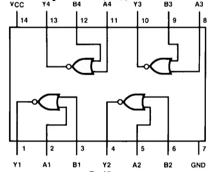

74HC02 Pinout
