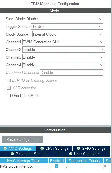

I am using an STM32Cube IDE and HAL library to generate two PWM using two timers.
I want these two PWMs to stop i.e go LOW after one of the PWMs has generated N pulses.
I don't know what to use in what mode. Should I use a third timer with a mode or something else?
EDIT: After reading the answer, I'm getting closer but still some issues PWM does not stop.

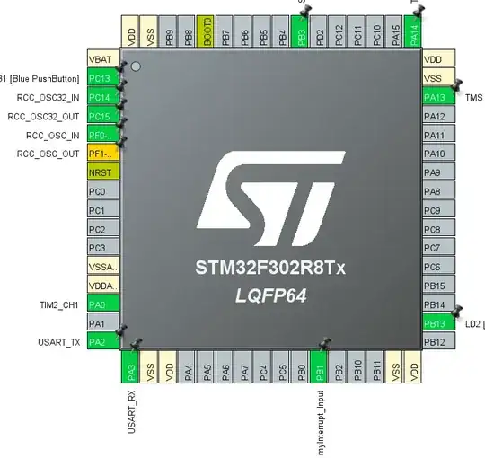

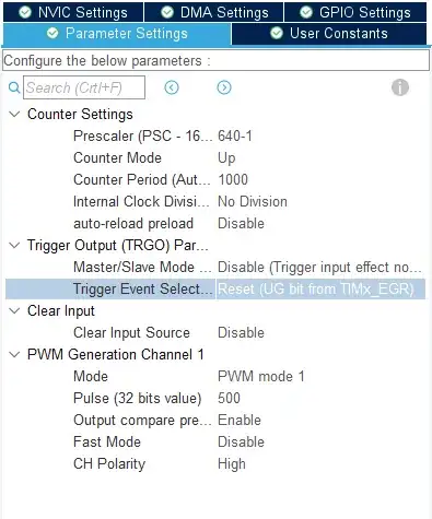

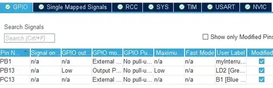

Here is my settings(NUCLEO-F302R8):
I set PA0 as PWM output and PB1(myInterrupt_Input) as external trigger input.
Here my main.c:

/* USER CODE END TIM2_Init 1 / htim2.Instance = TIM2; htim2.Init.Prescaler = 640-1; htim2.Init.CounterMode = TIM_COUNTERMODE_UP; htim2.Init.Period = 1000; htim2.Init.ClockDivision = TIM_CLOCKDIVISION_DIV1; htim2.Init.AutoReloadPreload = TIM_AUTORELOAD_PRELOAD_DISABLE; if (HAL_TIM_Base_Init(&htim2) != HAL_OK) { Error_Handler(); } sClockSourceConfig.ClockSource = TIM_CLOCKSOURCE_INTERNAL; if (HAL_TIM_ConfigClockSource(&htim2, &sClockSourceConfig) != HAL_OK) { Error_Handler(); } if (HAL_TIM_PWM_Init(&htim2) != HAL_OK) { Error_Handler(); } sMasterConfig.MasterOutputTrigger = TIM_TRGO_RESET; sMasterConfig.MasterSlaveMode = TIM_MASTERSLAVEMODE_DISABLE; if (HAL_TIMEx_MasterConfigSynchronization(&htim2, &sMasterConfig) != HAL_OK) { Error_Handler(); } sConfigOC.OCMode = TIM_OCMODE_PWM1; sConfigOC.Pulse = 500; sConfigOC.OCPolarity = TIM_OCPOLARITY_HIGH; sConfigOC.OCFastMode = TIM_OCFAST_DISABLE; if (HAL_TIM_PWM_ConfigChannel(&htim2, &sConfigOC, TIM_CHANNEL_1) != HAL_OK) { Error_Handler(); } / USER CODE BEGIN TIM2_Init 2 */

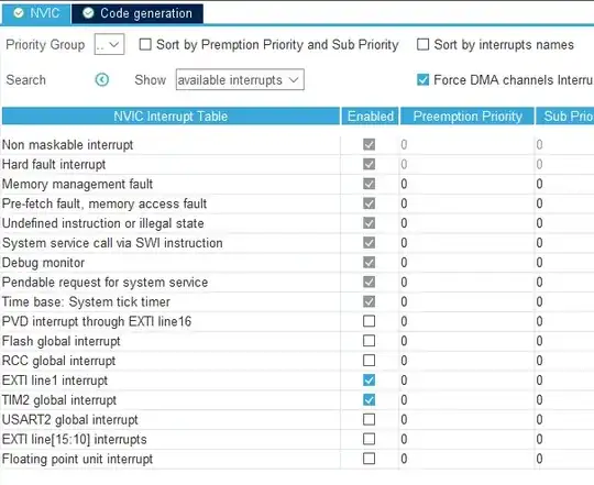

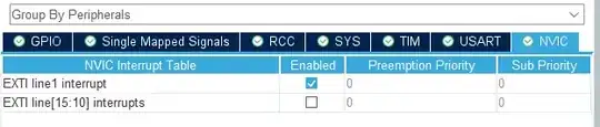

/* EXTI interrupt init*/ HAL_NVIC_SetPriority(EXTI1_IRQn, 0, 0); HAL_NVIC_EnableIRQ(EXTI1_IRQn);

  • I would also suggest reducing the interrupt priority for tim2 and EXTI1, it may be clashing with systick that HAL uses if you're triggering constantly. Again ,you'd see all of this if you stepped through the code with a debugger. – ChrisD91 Jan 28 '22 at 14:53
  • @ChrisD91 You mean sub priority here https://i.stack.imgur.com/Bf3x5.png? They are all set to zero. To reduce does it mean I need to set the other to 1? – cm64 Jan 28 '22 at 14:59
  • Priority is confusingly split into "priority" and "sub-priority" to just give the programmer more granularity if you have multiple interrupts. If two interrupts trigger at the same time and has the same priority, it then checks the sub priority to avoid clashes. Zero is the highest priority. Change the sub priority to 1 for tim2 – ChrisD91 Jan 28 '22 at 16:42

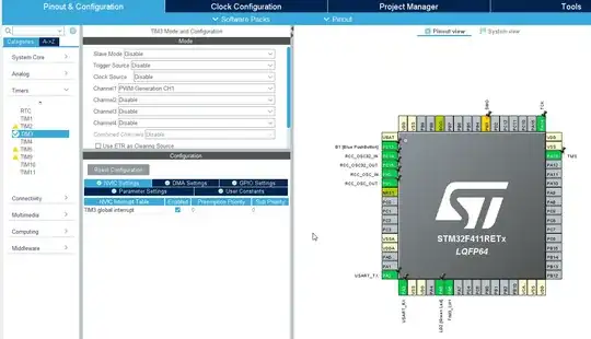

There's an easy solution to this using HAL as there are drivers that call a function every time a timer (in this case PWM) is called. You can just count the number of times the function is called and then stop your second PWM.
  1. Enable PWM as interrupt-based in the .ioc / cubemx page in stm32cubeide and generate code
  2. go to Drivers/xxx_HAL_Driver/Src/xx_hal_tim.c in project explorer window

CubeMX screenshot to enable PWM interrupt:
ChrisD91
  • 695
  • 18
  • Interesting and I want to try this. But how do you set PWM as interrupt base in Cube MX? – cm64 Jan 28 '22 at 10:42
    Added a screenshot to the answer. In cubemx you need to configure your parameter settings (I assume you've already done this) and then in the NVIC settings tab you have the option to enable global interrupts for that timer – ChrisD91 Jan 28 '22 at 10:49

  • In that case, set your digital input to interrupt mode and enable the HAL_TIM_PWM_Start_IT in your digital interrupt handler. Stop the PWM in the pwm callback and repeat. – ChrisD91 Jan 28 '22 at 11:32
  • Thanks, I did that like this void EXTI1_IRQHandler(void) { HAL_GPIO_EXTI_IRQHandler(GPIO_PIN_1);
    if(HAL_TIM_PWM_Start_IT(&htim2, TIM_CHANNEL_1) != HAL_OK) { Error_Handler(); } } But now the event starts with digital input rising edge but never stops
    – cm64 Jan 28 '22 at 12:06
  • And in main I have this: void HAL_TIM_PWM_PulseFinishedCallback(TIM_HandleTypeDef *htim) { if(htim -> Instance == TIM2) { if(htim->Channel == HAL_TIM_ACTIVE_CHANNEL_1) { global_pulse_flag++;
            if(global_pulse_flag > 55){
             HAL_TIM_PWM_Stop(&htim2, TIM_CHANNEL_1) ;
  • Here is the entire project: https://file.io/iybKyE7hhkx5 – cm64 Jan 28 '22 at 12:12
  • If the event starts correctly but never stops after your specific number of pulses, you're not stopping the PWM correctly or you're not counting the number of pulses correctly. You never stated how you're getting the digital input, if it's from a button you may also be getting a number of triggers on the interrupt due to bouncing. There's too many things to consider without knowing everything about your project and what you want to do. – ChrisD91 Jan 28 '22 at 12:23
  • It is digital input with voltage applied. I apply 3V with function generator to a digital pin. I set PB1 as GPIO_Ext1 with rising edge. I uploaded the project – cm64 Jan 28 '22 at 12:27
  • All is here: https://file.io/oLYzqsDrS7S6 I would appreciate this last bit or here https://easyupload.io/wg4mkz – cm64 Jan 28 '22 at 12:28
  • You're using HAL_TIM_PWM_Start_IT to start the PWM but to stop the PWM you're using HAL_PWM_Stop. You need at least to use HAL_TIM_PWM_Stop_IT. Check the driver file again and use the correct stop function for your code. You are using PWM in interrupt mode! – ChrisD91 Jan 28 '22 at 12:34
  • I tried that as well but PWM starts but never stops. It seems HAL_TIM_PWM_PulseFinishedCallback is not called at all. – cm64 Jan 28 '22 at 13:13
  • I will edit and share the files and config. – cm64 Jan 28 '22 at 13:13
  • See my edit. I shared everything there. The PWM starts when PB1 is HIGH. But never stops. I might be using your code wrong way. I hope you might have a look at this. This is the last step to achieve my goal. Thanks anyways. – cm64 Jan 28 '22 at 13:23
